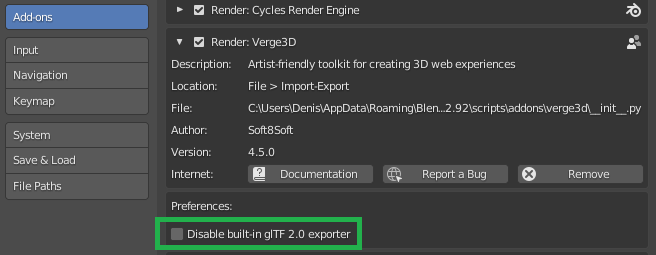

    I still need to use generic Blender GLB exporting when Im not using it for Verge projects. After this latest version, I’ve noticed the exporting in the standard Blender goes away and is sometimes hard to bring back even after disabling Verge plugins. Can this conflict be resolved?

    THANK YOU! Its never done this before and i’ve been using verge for a few years now

    A thing I begged Soft8Soft not to do. Its one of those things you get when a company tries to make something easier for new users. Instead of new users learning to select the correct export they cause confusion for those that have other uses for the default GLTF exporter…UGH.

    They had already told us why they removed it default from menu. I think 80-90 percent times we use gltf only so its from work efficiency point of view.
    Anyways you can enable it when needed.
    This feature appeared nearly a year ago in Verge3D 4.4 :yes:
