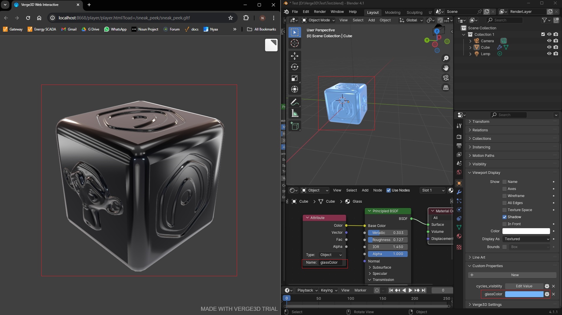

ParticipantI try to add a custom property to change an object color in Blender as shown in the attached image.
The blender view renders it correctly but in Verge 3d it doesn’t understand this custom property.In the render tab, I check the Export Custom Props as well. So it seems I miss a setting here. Appreciate any help.

ParticipantCustom properties work fine, but the node “Attribute” you are using is not fully supported in Verge3D.
https://www.soft8soft.com/docs/manual/en/blender/Shader-Nodes-Reference.html#Attribute

xeonCustomerto change a color of an object in V3D there are a few options:
You can assign the object a new material.
You can assign the object a new texture.
You can use a value node in your shader and adjust the value node via puzzles.
You can use a mix shader node and value shader that influences the factor of the mix shader node.There are other ways…too…just the way you were going about it wasn’t going to work.

ParticipantI understood nothing of what you said ))) But if you want to use only one material for several objects and you want those objects to have different colors then you’d better use “Object info” node in Blender.
