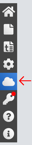

    Do you mean uploading to Verge3D CDN (the button with an arrow pointing upwards)?
    #35897
    hasanyluthfi
    Yes

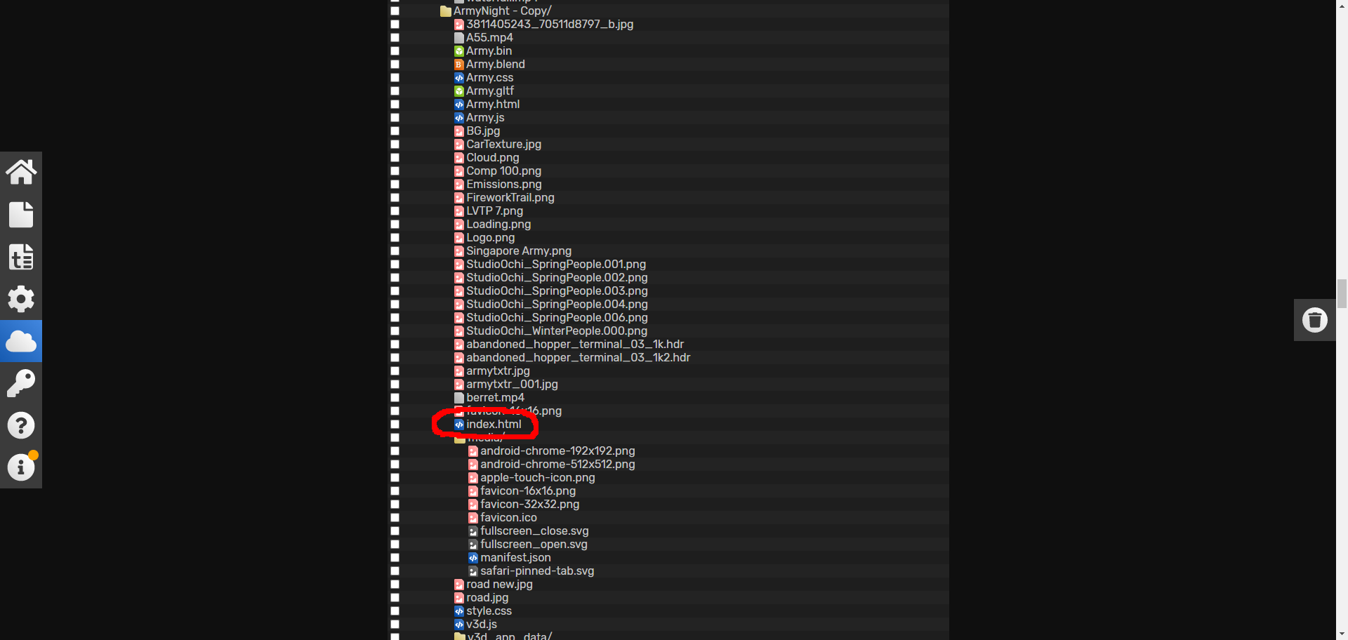

    If you go to the Verge3D Network Directory in the App Manager there should be the listing of all the projects/files you’ve uploaded:
    Is index.html listed there?

    also, I check mark the upload app sources
    on the network directory, the index.html also not uploaded.
    also try to duplicate it and upload it, and still doesn’t work.
    #35979
    So, does the link “index.html” not work if you click on it?

    ok the index one can properly.
