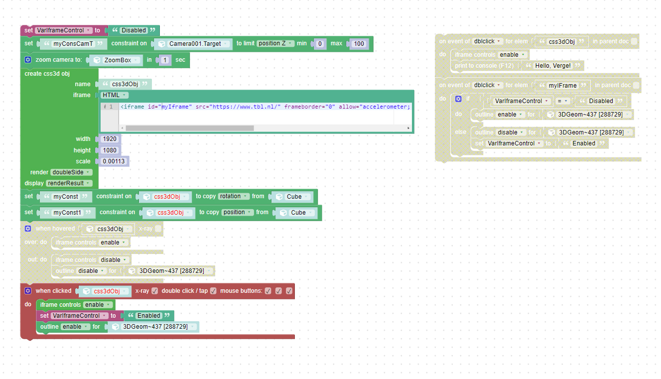

sirhcCustomerHi there,
I’ve been experimenting with the ‘CSS3D plugin for Verge3D’;https://cdn.soft8soft.com/AROAJSY2GOEHMOFUVPIOE:ac6e684bfe/applications/3D_TBLapp/3D_TBLapp.html
#1
I’m trying to disable the ‘iframe controls’ on dubble-click/tap on the iframe. I can’t get it to work.#2
Also the ‘when over—>on out’ puzzle seems to be triggered any time you leave the object even when the puzzle is disabled. This is less of a concern to me….but I thought it would be worth mentioning…Anybody any insights???

2021-02-20 at 3:41 pm #38760
zjbcoolCustomerHi zjbcool
Bubble click on the screen object itself to toggle the iframe controls on & off.It is impossible, because the css3d object is in another layer(renderer). But you can create a html button on body to toggle controls.

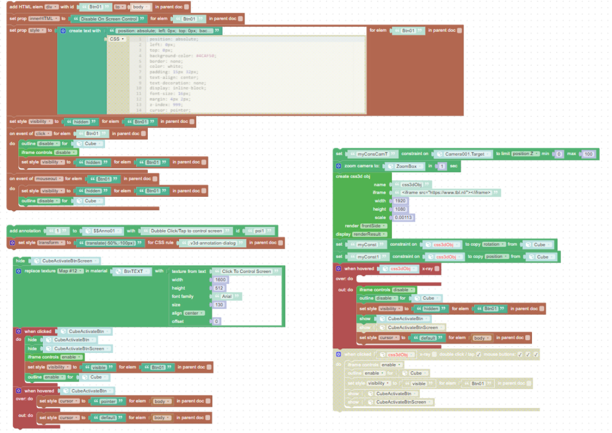

2021-02-23 at 10:47 am #38822
sirhcCustomerHi zjbcool,
tried working around this,…..made the body button as you suggested for disabling iframe controls, thats kinda oke now,…But now:
I also made an activate button. In front of the screen.
But now my mouse becomes ‘sticky’ leaving the ‘css3dObj’-object.
Any idea why/how?
Tnx already!!New Project link:
https://cdn.soft8soft.com/AROAJSY2GOEHMOFUVPIOE:ac6e684bfe/applications/3D_TBLappV2/3D_TBLapp.htmlAttachments:
Technical Artwork Specialist@TBL.nl
2021-02-23 at 1:38 pm #38826
sirhcCustomerKinda Fixed It…!!
https://cdn.soft8soft.com/AROAJSY2GOEHMOFUVPIOE:ac6e684bfe/applications/3D_TBLappV3/3D_TBLapp.html
mouse——>the double click is necessary
touch——> different story: looking in to it (buttons in iframe don’t work
)Technical Artwork Specialist@TBL.nl

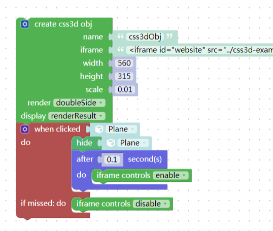

2021-02-23 at 2:20 pm #38828
zjbcoolCustomerHi,
try this
2021-02-24 at 9:47 am #38843
Tnx again for your efforts so far, much appreciated!!!
Tried your suggestion with the timer, must say my option with the ‘variable’ clicks al little better,….(not by much thou ;)).

2021-03-03 at 4:40 am #39071
zjbcoolCustomerHi,
@sirhc After a week’s work, I think I implemented the feature that you want. I added 2 new puzzles for it. It works fine on mobile devices. See the 2nd way in the example.
https://cdn.soft8soft.com/AROAJSY2GOEHMOFUVPIOE:509b0f0e57/applications/css3d-example-blender/css3d_demo.html
And more, the CSS3D plug now supports YouTube Iframe API, so we can contorl the video playback from outside. New 4 puzzles for this feature.
by the way, when you use YouTube Iframe API, you may need HTTPS in localhost, Caddy is a tool for this, and easy to use. :) :) :)
