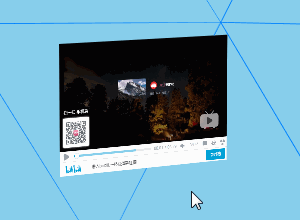

Yuri KovelenovStaffYou can now embed live websites into 3D environment!
Check out the CSS3D plugin by zjbcool:

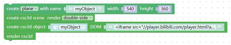

zjbcoolCustomerCSS3D UPDATE:Zjbcool-css3d-v1.2
support verge3d 3.6’s ‘create object’ puzzle.So you can create css3d object without the need in a 3D editor.

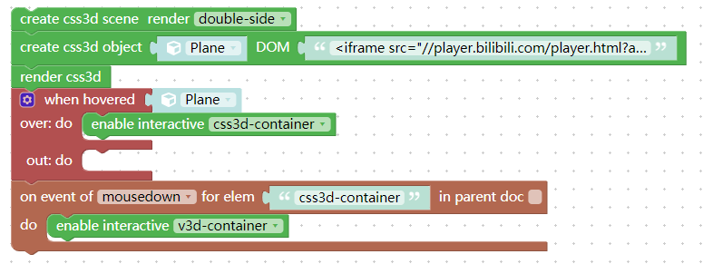

zjbcoolCustomerCan you play/pause the video by just clicking on the plane? Or any other object?
you can use “when hovered” puzzle to active the css3d interaction, and use “mousedown” event to back
