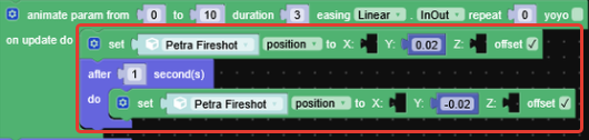

ParticipantDo you understand what’s going on here? Especially the second puzzle…
2023-10-24 at 1:38 pm #67878
c4ccParticipantMy intention was to have the bullet return to the starting point so it could fired again.
2023-10-24 at 1:41 pm #67879kdv
ParticipantDo you know in how many seconds your fireball will actually return to its initial position? Acorrding to your logic.
2023-10-24 at 3:12 pm #67880
c4ccParticipant1 second. I’m trying to make shots fire with an interval of 1 second per shot.
2023-10-24 at 3:45 pm #67881kdv
Participant1 second
Wrong. 4 seconds in fact.
2023-10-24 at 4:03 pm #67882
c4ccParticipantI see now why, because of this duration 2, thus adding 3 extra seconds to the fireball. Now, how do I get the shot fired in a straight line without it lagging or going up or down whenever the character does so?

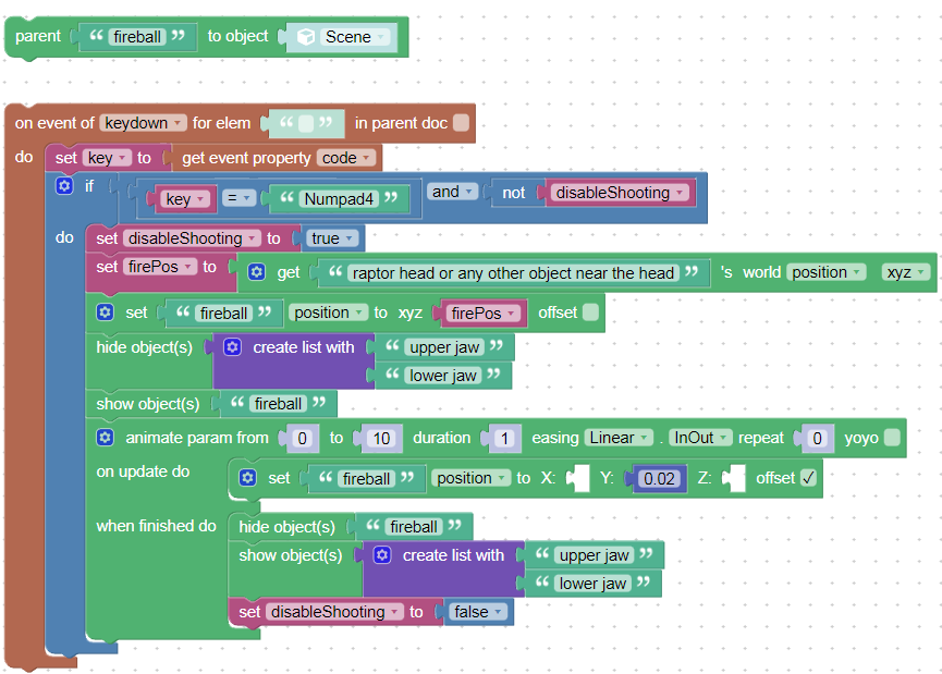

2023-10-24 at 4:12 pm #67883kdv
Participantwithout… going up or down whenever the character does so?
your fireball is parented to the object which is moved by keys. but it should be independent to move in global coordinates. think. you should clearly understand the difference between global/parent/local coordinates…

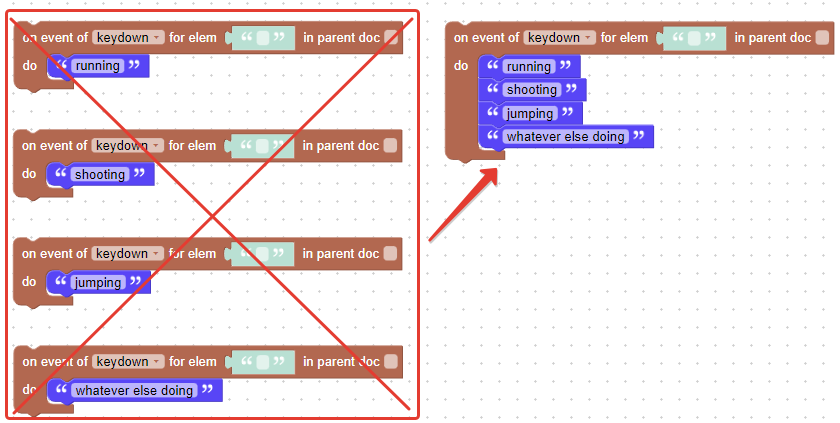

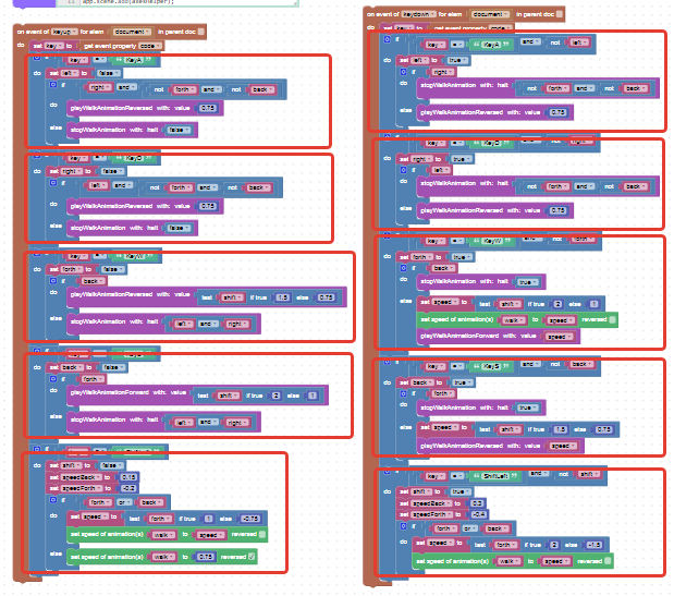

Btw, it’s a bad approach to use duplicate code. You already have the event listener puzzles added, there is no need to add the
keydownandkeyupevent listeners for every key.
2023-10-24 at 5:09 pm #67885
c4ccParticipanthold on…
2023-10-24 at 5:25 pm #67886
c4ccParticipantBtw, it’s a bad approach to use duplicate code. You already have the event listener puzzles added, there is no need to add the
Um, is this directed at me, or someone else? Doesn’t seem to fit in here, as these are running puzzles, not shooting

2023-10-24 at 6:23 pm #67891
c4ccParticipantyour fireball is parented to the object which is moved by keys. but it should be independent to move in global coordinates. think. you should clearly understand the difference between global/parent/local coordinates…
Yes, character can now move away as fireball moves a fixed distance. Unfortunately, I press the shoot button, and the fireball fires from its last position. How do I shoot a new fireball, instead of making the previous fireball continue another distance.
I unparented my fireball using this:
2023-10-24 at 7:20 pm #67892kdv
ParticipantMy puzzles:
2023-10-24 at 8:41 pm #67896
c4ccParticipantUnfortunately, it’s not working, fireball is fired only from a specific place, not from the character’s certain place itself when it moved around. Also, unfortunately, fireball “resumes journey” when shoot button is pressed, instead of a new fireball coming out from character’s certain place.
2023-10-24 at 8:59 pm #67897kdv
ParticipantYou got exactly what you did
It’s a little bit senseless to place the fireball at the position of the fireball. The fireball is already there.
