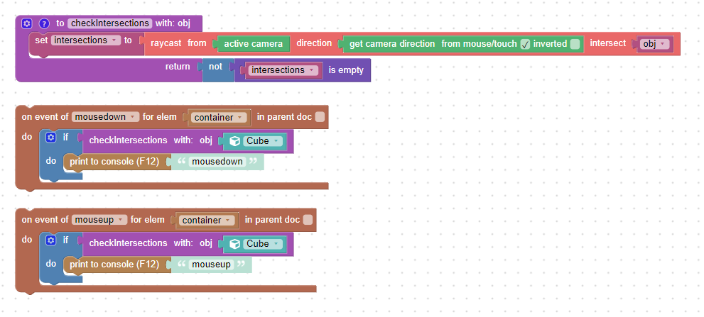

    Hi, can i use Puzzle logic to handle separete mouseDown and mouseUp event when clicked on object. I need to simulate button press and hold when i clicked and hold on object(play object animation, and send data until it pressed) and when i release mouse button play another animation and send another data.
    #40244
    Sure, but you need to use the event puzzle for that. To detect the object under the click, also use the raycast puzzle.

    #40304
    Here’s an example of such puzzle setup:
