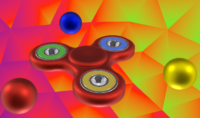

    Is it possible to distinguish between 2 events, Drag and Click?
    Le’s take the spinner demo: https://cdn.soft8soft.com/demo/blender/spinner/spinner.html
    If i drag but my starting drag location on the screen is on a color bubble, it will also click on the bubble.
    I just want to drag, not to click.
    If I want to click, I click on the bubble without dragging.
    There is no “Exclude Drag” on the click event. Or maybe there is another solution?
    Thanks.

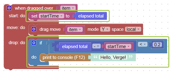

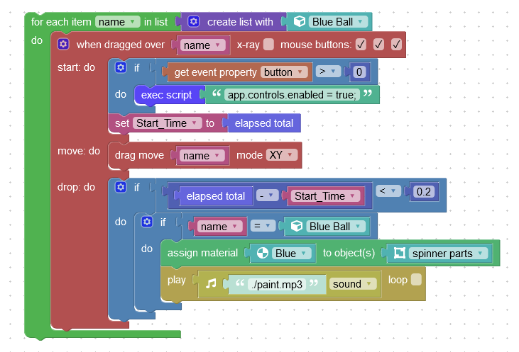

    #66473
    Those puzzle both require clicking but in a different way
    That’s how you can get rid of when clicked and use when dragged over both for dragging and clicking

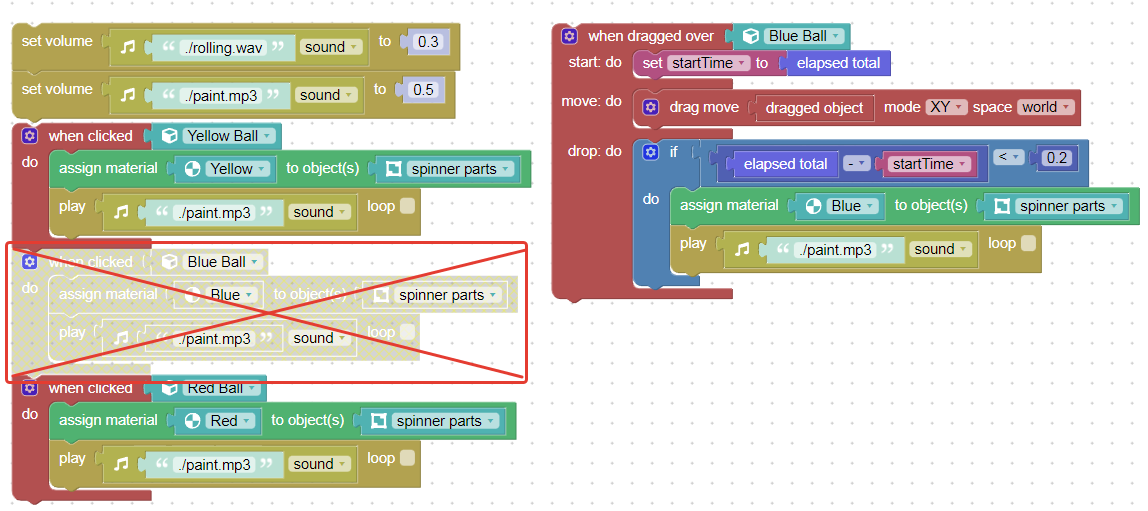

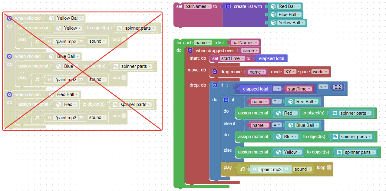

    #66484
    For one ball
    For all balls
    https://v3d.net/nda
    #66488
    Fabulous FOUR
    Thanks! Now there is no click event when start dragging! And I can manage the click nicelly. Really useful tip!

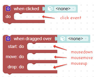

    #66489
    I’ve tried to keep the camera panning on the “move: do” but I can’t reach this result. Any idea ?
    The camera controls are intentionally disabled when you try to drag some object.
    You can enable the camera controls back but the result will be opposite to what you are expecting.
    https://v3d.net/nda
    I don’t have the “dragged object” puzzle
    That’s from my plugin. You don’t need it.
    nor the option on “drag move” puzzle.
    That’s a new puzzle introduced in 4.5.0 pre1

    You mean you don’t want objects to be clicked when you start the camera rotation with the cursor over the objects? Use “double click/tap” for triggering.

    You’re expecting too much. How should the app understand what you are going to do if you pressed the button when the pointer is over the draggable object? Maybe you want to rotate the camera without dragging? Or the next time you want to drag without rotating? That’s why the controls are disabled when you click on draggable objects. If you enable them you will drag an object and rotate the camera at the same time.

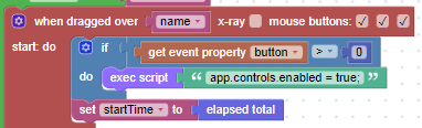

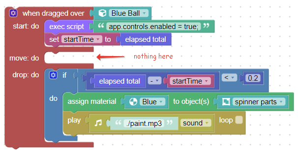

    #66506
    Then you shouldn’t have talked about dragging initially meaning the scene’s camera rotation )))
    And it’s easy to do using when dragged over (when clicked won’t do).
    https://v3d.net/nda
    #66508
    Fabulous FOUR
    Bingo! Sorry for my bad english and well done. Thanks a lot!
