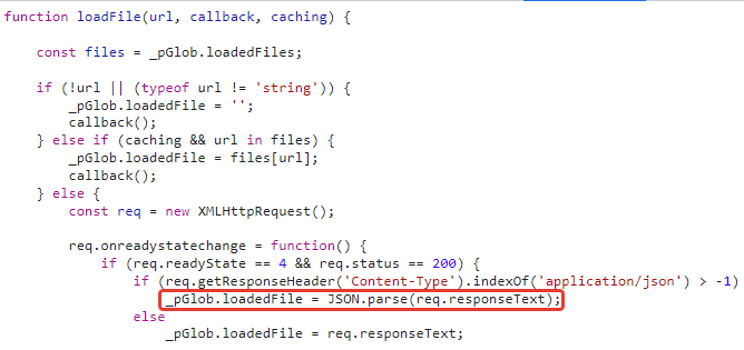

    #66300
    https://cdn.soft8soft.com/demo/blender/custom_image/custom_image.html?image_url=https://sandbox.soft8soft.com/wp-json/verge3d/v1/get_file/1692648345
    You’d better remove these three lines introduced in 4.2.0
    “read JSON from” worked and works well without this questionable piece of code.
    #66305
    It’s actually bug in the WordPress plugin that responds with incorrect MIME type. Going to fix it soon. Thanks for reporting!
    Unfortunately, many non-technical users do not understand how JSON works. Automatic parsing would be much easier for them.

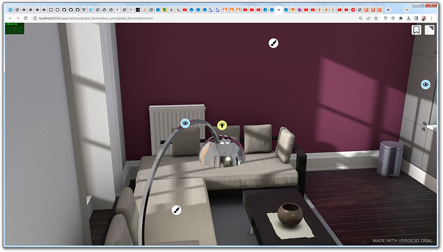

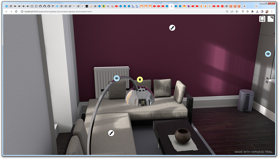

    The Global Illumination demo which uses ESM shadows
    I just wonder what for? PCF shadows give much better result and work definitely faster. Even cascaded shadows (CSM) work faster.
    4k ESM shadow looks a little strange in that demo :scratch:
    while PCF shadow simply looks like a normal sun shadow.
