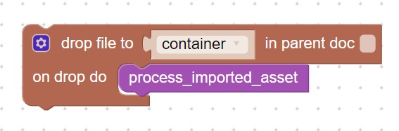

    #70344
    rodrigogama
    Thank you for your response! But I’m already opening the file outside this procedure.

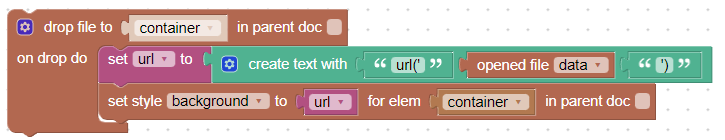

    #70346
    Wrong syntax – wrong result. Should be this way
    #70351
    rodrigogama
    It works! thank you :)

    #70684
    The difference is just in syntax. What can be used “as is” in the replace texture puzzle cannot be used without url(' ') for CSS styles.
