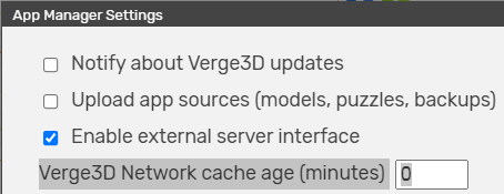

    johngrigni
    So nothing inside the verge workspace?
    #52595
    only this
