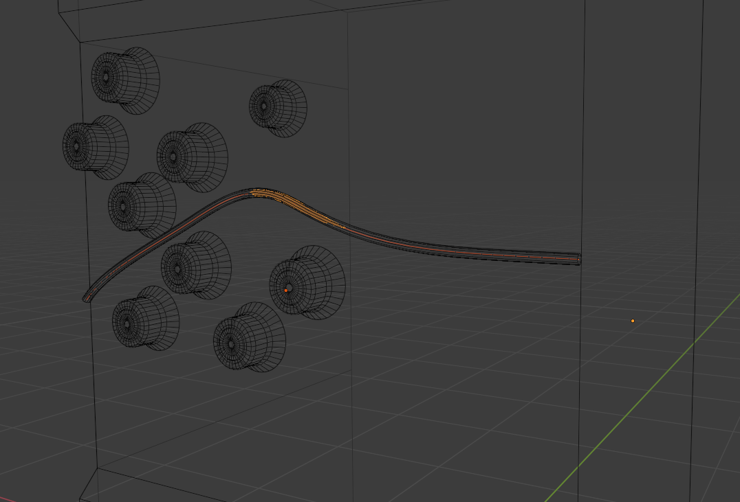

I want to do an animation of an object animating with a curve path, however when I expert this to the verge, the animation doesnt hold its position. Is there a way to get this fixed. And selected item has a transparent material its not transperant in the Verge on browser any fix for that too?

Thanks again for responding, attaching the blend file for your reference, i have not rigged anything, its just a simple Sphere crushed to look like fluid with a Curve modifier and moving it along a target curve. Please help me out.

Mikhail LuzyaninStaffYes, you do not rig anything, but you need to do this if you want to achieve something like you have in blender. It’s the only way.
