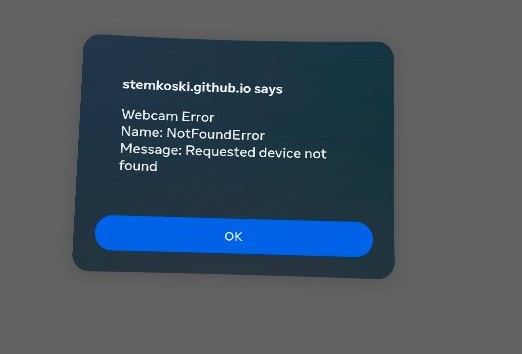

2024-06-21 at 6:05 pm #75194
visualizerParticipantThese links worked as expected on normal phone device.
However on Quest3 this gave error message. check screenshot.
May be this site & Quest 3 both are not friends yet. It doesn’t recognize the Quest3 camera / lens yet.
2024-06-21 at 11:49 pm #75203kdv
ParticipantTaking into account that even the simplest webcam app doesn’t work in the Meta Quest browser, apparently it’s a Meta Quests issue
Maybe someday mr. Zuckerberg will fix it
