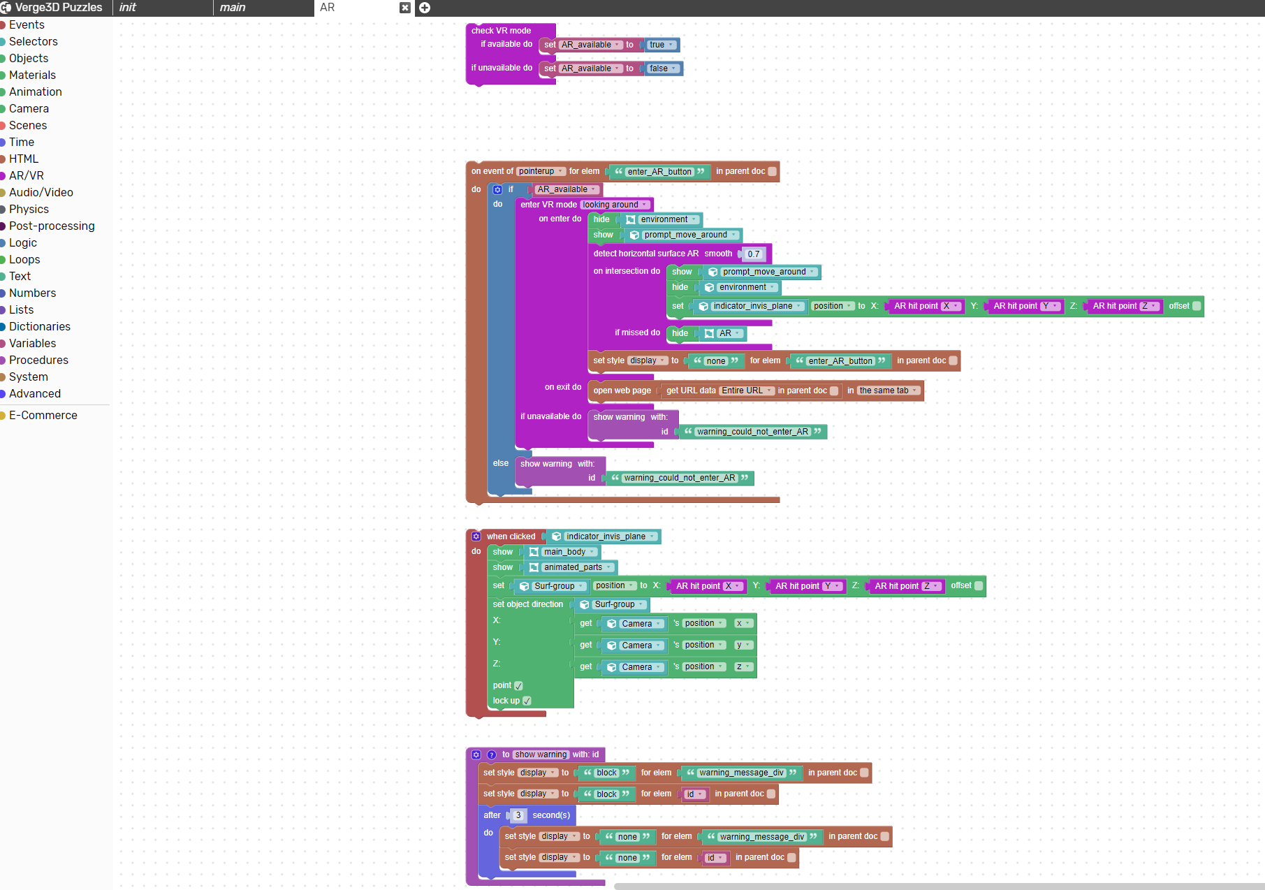

    i’m now trying to add the AR module to my project, i read the documentation and used some parts of the AR example using the same button, class and id trying to avoid errors.
    But when i click the “enter AR button” nothing happen.
    I think the reason is because the app originally don’t have the legacy ar module, this can be the reason?
    I also used a new tab named “AR” instead of the “Main”, this can generate this kind of issues?
    Thanks to everybody in advance,
    Marco

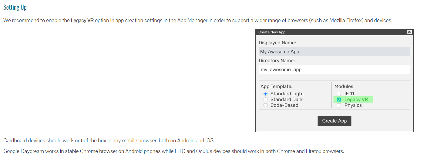

    #37814
    the legacy module only helps for VR.
    does the original AR demo work for you?
    #37815
    sickmind
    I would love to add also the vr button after.
    The ar demo works for me or, from pc, the warnings appears. With mine nothing of both 🤔
    I’m working with dreamweaver on the html side.
