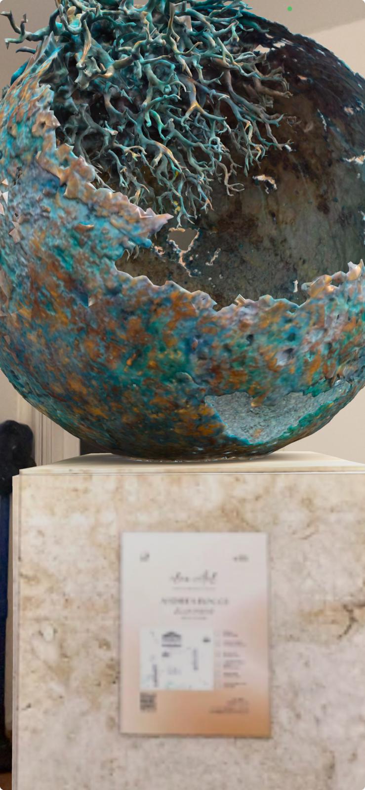

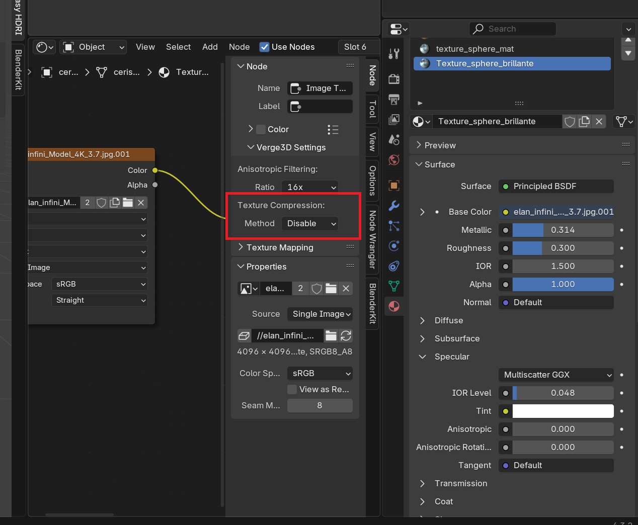

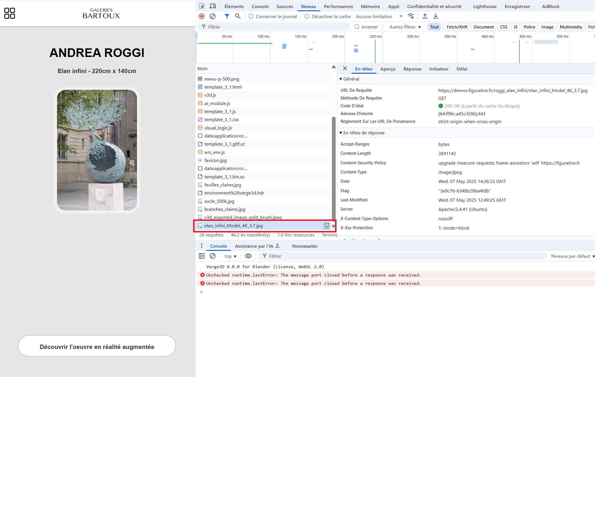

I am experiencing a texture issue when my object exports in augmented reality on IOS.
The resolution is much lower than it should be.Since, the image texture is correct on android and also correct on IOS when I use a different method than Verge3D, I was wondering if the pluggin set a limitation on the image texture when converting into USDZ ?
In another post, Alexander suggests to set to native resoltuion mode, which I did.

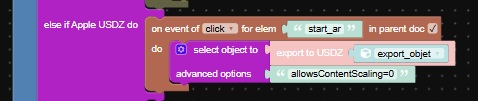

2025-05-08 at 3:00 pm #81812kdv
ParticipantI am experiencing a texture issue when my object exports in augmented reality on IOS.
The resolution is much lower than it should be.this function reduces textures to 1024 when exporting to usdz.
2025-05-08 at 7:35 pm #81818gestion
CustomerThanks.
And how can I avoid that compression to 1024 ?
Is the function included in the plugin and can it be removed ?Attachments:
2025-05-08 at 7:39 pm #81820kdv
ParticipantAnd how can I avoid that compression to 1024 ?
You can ask them in S8S to do something with the “export to USDZ” puzzle
Is the function included in the plugin?
Nope. My plugin just uses that standard puzzle for exporting.
