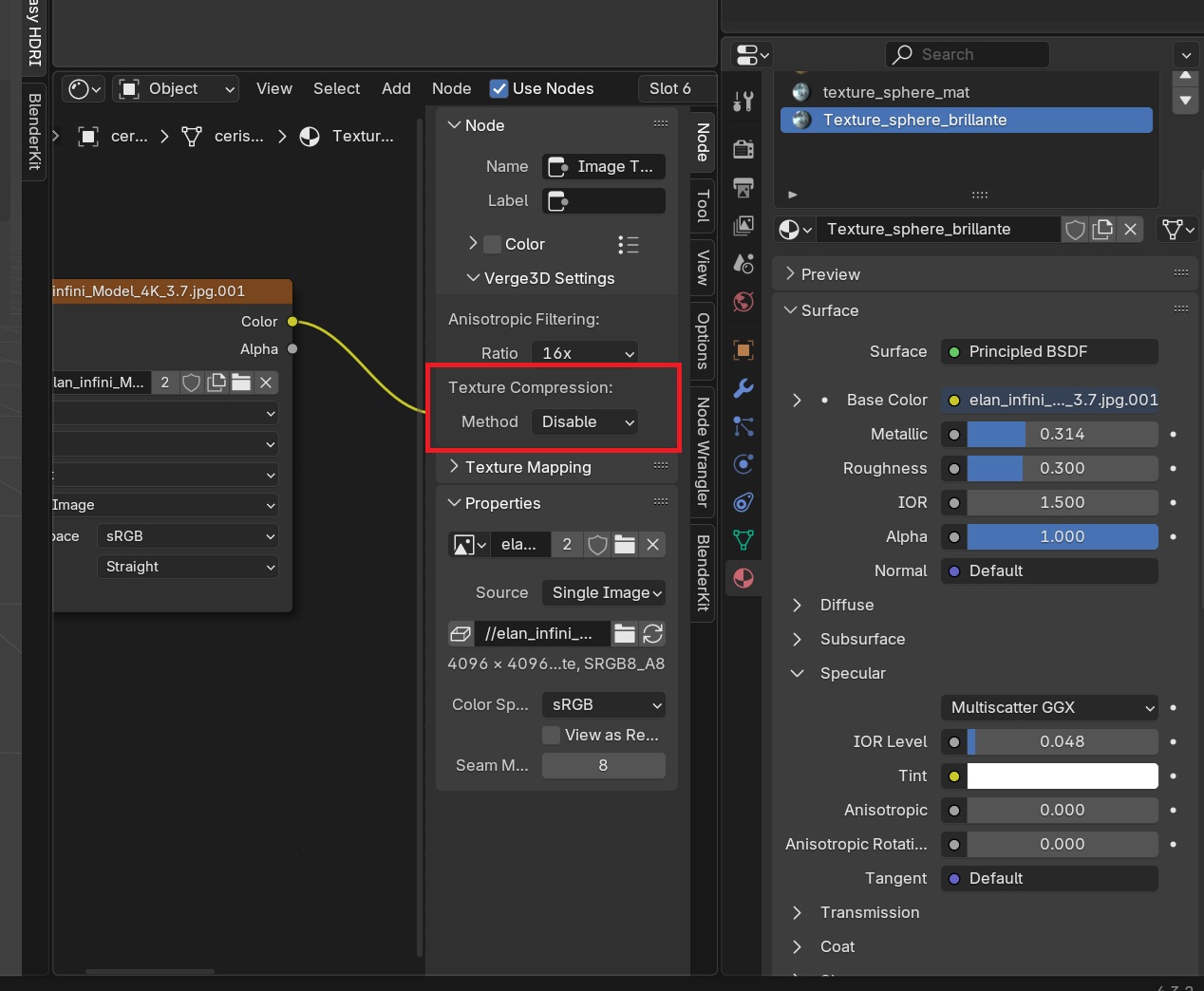

When I export my object in augmented reality, the image texture quality becomes very low.
It seems to be compressed somehow.
How can I ensure no compression ? I don’t mind to mind to wait a few seconds (the object currently appear in AR almost instantly)For comparaison, I have exported my object using Verge3D and with another tool so we can clearly see that Verge3D compress the image.

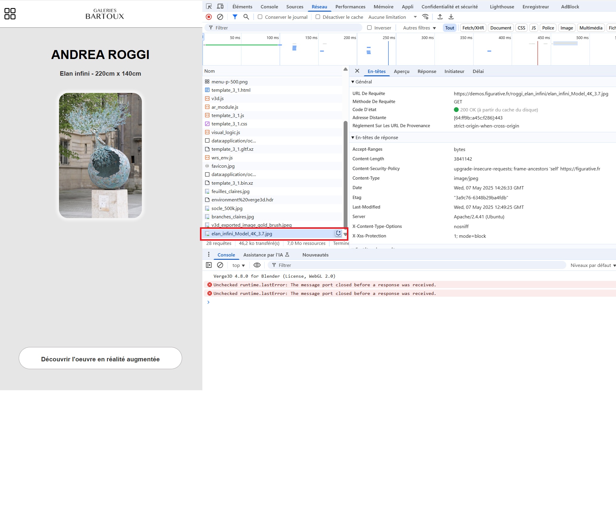

The image texture is 4096×4096 and 3,66Mo.2025-05-08 at 7:40 am #81801
Alexander KovelenovStaffHi,
Perhaps it’s not the texture, but the reduced resolution of the 3D canvas. Try to switch your canvas to native resolution mode to see the difference.2025-05-09 at 6:41 am #81821gestion
