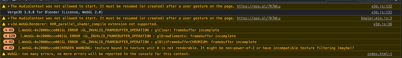

Console messages are attached. If anyone can help it would be greatly appreciated. Thanks!

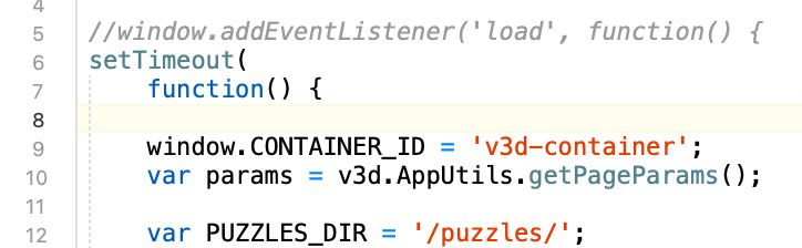

I made a (very hacky/horrible) change to the code, so that the main verge js content only fires after 2 seconds have passed. Screenshot attached.
This has stopped the problem (at least on my end), but I am aware that this is not a good solution.
The iframe and canvas element are initialised at the correct size, it is only that the z-index puts them behind a rectangle so they can’t be seen when the page first loads.
I’m sharing this in the hopes someone might be able to use this information to determine what the actual problem might be. It might be related to the way Tumult Hype handles things, perhaps.
Here is the link for the new (hacky) code that is at least working: https://content.une.edu.au/2022/3d_explainer_1s/index.html

Yuri KovelenovStaffStill black screen for me with error “Framebuffer is incomplete: Attachment has zero size.” meaning the WebGL canvas with zero dimensions. I think this is because Hype generates the HTML elements on the fly, so the canvas size is not set when the Verge3D app is initialized.
I’d try to bypass Hype’s iframe. Instead, you might add an element, a rectangle. Double-click and click on the pencil to edit the innerHTML. Add an iframe element like
<iframe width="100%" height="100%" frameborder="0" src="my_awesome_app.html"></iframe>(I modified this advice)
