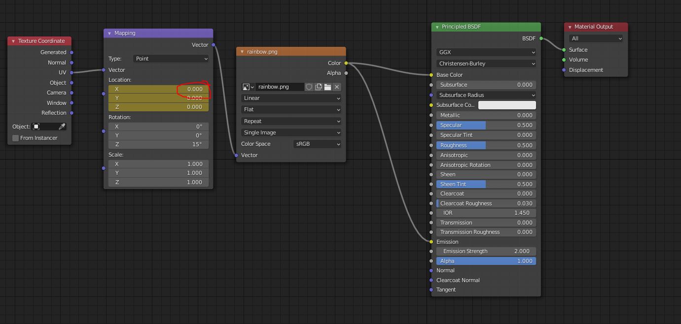

    I have a simple Principled BSDF material with an image texture .png assigned to the base color and emission. The material is assigned to a plane. I have animated the position of the image using the mapping node. Its a simple movement across the face of the plane. Works in Blender EVEE does not work when I sneak peek it and export the GLTF for the app manager.
    My original plan was to animate a color ramp across the plane so I wouldn’t have to use the .png but that didn’t work either. I have searched the forum and haven’t found much. This is an easy task, I am new to the software so forgive me if I a missing a simple detail.
    Please help. On deadline with a project.

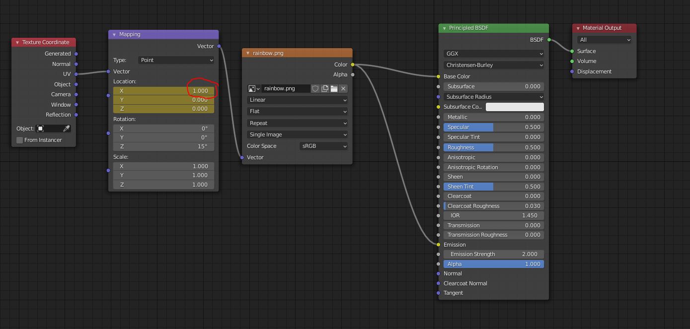

    haris
    I tried to create something like this but it’s, you can use a value node with mapping node and attach it to location and then and in verge 3d puzzles from materials tab there is a puzzle set value. :)

    Animation of materials possible only via RBG and Value nodes.

    Chris Wheeler
    Thanks! Value node works great. I appreciate the quick response.
