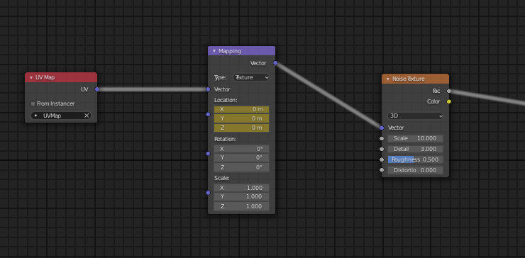

NaxosCGCustomerHi there, i up this topic for additional request :
Animating base color / diffuse color works great, but not normalmap / bummap…
When i put my animated UVoffset of my normalmap connected to diffuse / base color, it is animated. But when i put it into bump / normal map slot, nothing moves.It’s a putty as i need to animate some swimming pool’s water plane…

xeonCustomerIts basically animating a sprite sheet. The real difference is the texture in this example is static with with a UV repeat. Principle is the same.
Tutorials - https://www.xeons3dlab.com2024-01-15 at 1:42 pm #69704
NaxosCGCustomerNice tutorial, John,
Problem is that my guess is that it does not work with NormalMaps, as i’ve used simple UVoffset animation.
I’ll dig into it, if not working i’ll start a new topic and share files."1+1=3... for large values of 1"
2024-01-15 at 2:18 pm #69706kdv
ParticipantIn Blender it works with any texture. Water is animated this way using normal maps.
2024-01-15 at 3:50 pm #69708
xeonCustomerYes it works with normal maps
Tutorials - https://www.xeons3dlab.com2024-01-15 at 8:49 pm #69710
NaxosCGCustomerOk i’ll test it (3dsmax, not blender, but i guess i can adapt)
2024-01-16 at 12:04 am #69714
xeonCustomerSame basic principal…. just animate the UV map.
