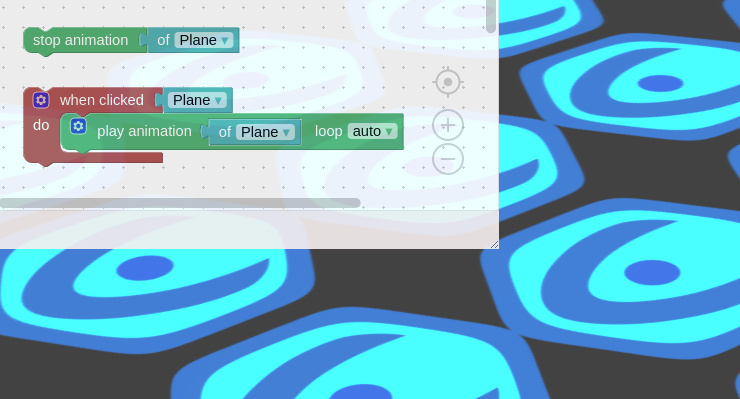

    #18906
    Yuri Kovelenov
    Yuri Kovelenov
    Developer
    I made a simple setup with animated texture (file attached). You can control the animation with Puzzles as well.
    3D Verger, the CEO
    #18916
    Avatar
    Innovation
    Licensee
    Hi thanks
    For some reason my animated texture is not being recognised once i export my gltf file from blender to verge3d
    #18917
    Avatar
    Innovation
    Licensee
    thanks i have just tested your file in verge3d and it works
