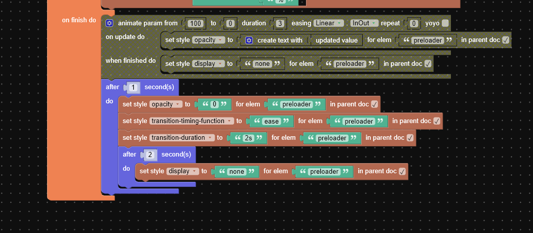

    Is there a reason why the animate param puzzle doesn’t work in the init tab? I want to use it for some CSS to fade out my preloader div. I was able to copy and paste the puzzle over from a separate puzzle tab, but it didn’t function (which I was guessing it wouldn’t).

    I am sure someone at Soft8soft will have a better explanation but to me these are things that run immediately prior to the loading of the scene.
    In the case of a preloader…the control of the preloader other than the initial call is all in the parent document. So you would be better off, controlling the CSS fade out in the parent document than trying to do it via puzzles.

    Thanks Xeon. It just leaves me with this below clunky puzzle set up, which avoids using CSS. I use the animateparam strategy elsewhere in my app to great effect. And to use the great functions that are given unto us…
