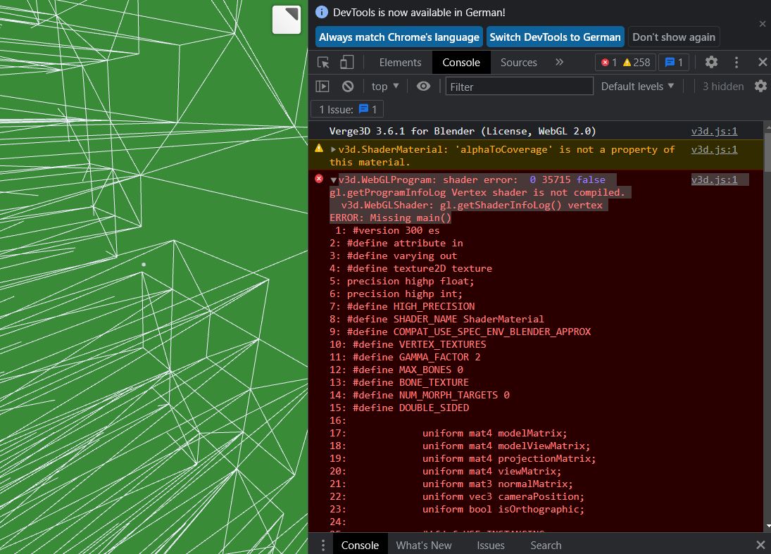

justin_blenderCustomerHello Yuri,
I was trying to implement this shader:
https://cdn.soft8soft.com/demo/examples/index.html#webgl_lines_fat_wireframe
I just had a look at this one
https://argos.vu/V3D/examples/index.html#webgl_materials_wireframe
too, it seems to be a bit more simple. I KIND OF managed to implement it, but not without having troubles (see image)
I dont know which of both is a “three.js” compatible one.
