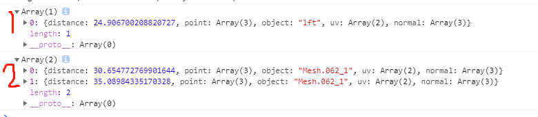

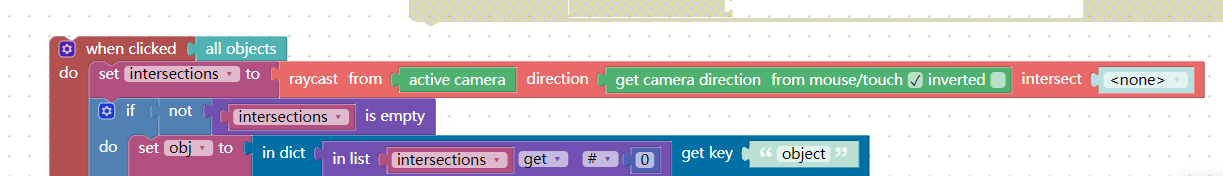

ParticipantI tried to use the intersections and raycast,want to get any objects when they are clicked.use the puzzle just like this:
but when i click the model cube ,i can get it
when i click the complex model i imported from blender,i can’t get it,just get the subobjects
so i need your helpAttachments:

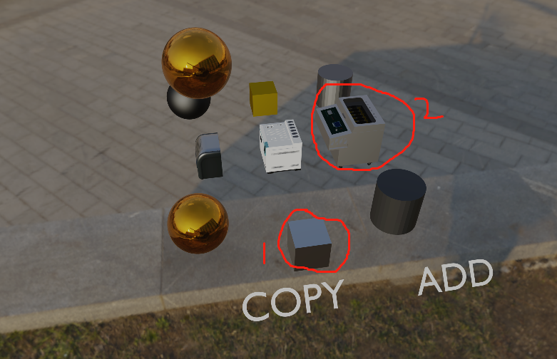

zirenjianCustomeryes,the complex model can be recognized now.but the model which is cloned or load by append scene gltf format can’t still be recognized.when clicked,has no response.i made a video in the package named “verge3d” to you on the wetransfer.

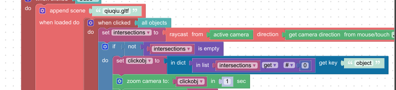

Alexander KovelenovStaffGlad you resolved the first issue. As for append scene, the “all objects” puzzle gets resolved once it appears in the puzzles pipeline (this is a current limitation of puzzles). You should assign you when clicked puzzle again once you load another scene dynamically:
Of course this example is just a quick fix, for more precise results you should name all of the loaded objects and assign “when clicked” on them.Attachments:
