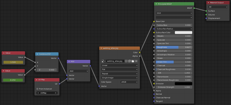

    I m trying to use the welding sparkles from Robot scene. But when I see in V3d is doesnt show at all. Can anyone help on how to do this?
    I am sharing my simple scene blender file here.
    Questions –
    1. Is that all node setup necessary to do? As done in an industrial robot scene.
    2. Is it possible to achieve the similar effect by using Anim all in blender?
    Regards

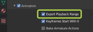

    Your sparkles are not visible. Just make them visible to see the animation working.
    And activate this option to play the animation in a continuous loop.

    No special function will work, only material animation will as it done in the Industrial Robot demo.
    #63857
    It can be easily reduced to this one.
    https://v3d.net/jpj

    yeah got it … So it was that little buddy which i forgot to enable. I was looking for V3D settings from my side if anything was missing …lol
    This clue worked. Thanks.
