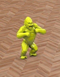

    Here is my prototype : https://v3d.net/b6i
    menus, buttons and choices are not yet finals, but it works iOS and Android !

    Since this test i’ve worked on future Billards tables, usin AR.
    It is very fonctionnal, but it comes with constraints :
    – Use meters
    – Use USD shaders

    jojopellerin
    problem fixed
    • This reply was modified 1 year, 7 months ago by jojopellerin.
    #67549
    NaxosCG
    As long as you use USD materials, it works.
    USD shader (with 3dsmax at least) has an occlusion map where you can put your AO map.
    Also, if you get gaps, you should probably use larger padding when baking AO maps (4 pixels for ex.)

    jojopellerin
    Thanks Naxos
    “Also, if you get gaps, you should probably use larger padding when baking AO maps (4 pixels for ex.)” –> it was this indeed :good:
    “USD shader (with 3dsmax at least) has an occlusion map where you can put your AO map.”
    It seems easier than Blender then. Unless I am missing something, I have to use a Mix Shader to blend with my color but then it get “lost” when exported to USDZ. Only color remain.
    Hopefully someone using Blender will help me to figure this out (blending each color with AO on Photoshop is a pain)..

    Double check the USD shader for AO slot (occlusion map, or something that would do so)
