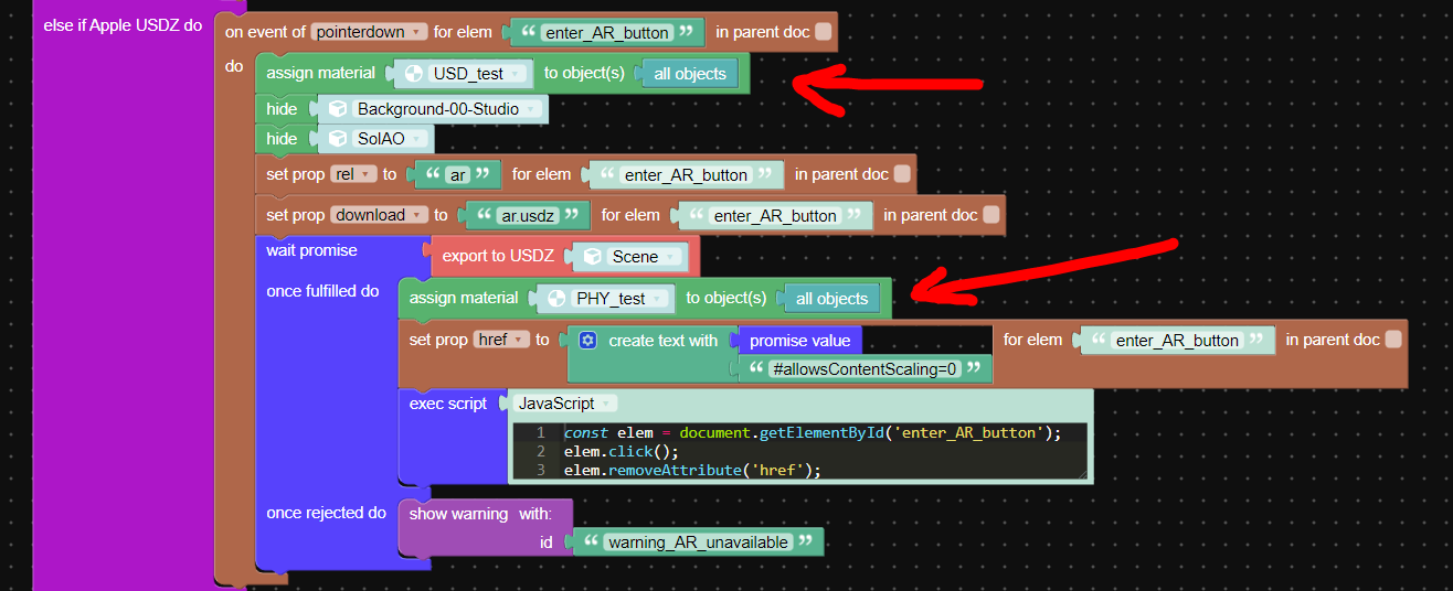

    So i put all that into the “else if Apple USDZdo” ?
    Yeap, exactly. Remove all puzzles from there and put this puzzle set.
    Works, many thanks.

    About your puzzle to use current choices to export USDZ, there is no “on exit AR” slot, that could help me.
    Let me explain :
    To prevent the need of channel2 for AO, i can use dynamic AO within verge3D, but it only works with physical materials.
    USDZ export doesn’t work with physical materials, so i thought about :
    enter AR : assign USD materials to objects : export scene
    but i need :
    exit AR : assign back PHYS materials
    The android part does have an on exit do. is there any way to have one also for iOS ?
    #56008
    That’s because you do not enter AR on iOS ))) In fact, you just export visible meshes to .usdz file and download this file. Then AR Quick Look opens this file.
    #56009
    NaxosCG
    I get it, but that is a problem so.
    I thought to change material, export, then assign back physical materials.
    I’ve tried to put the assign back at several places (just after the USDZ export, for ex.), but when i click close the AR, i’m back in verge3D with USD materials, not PHYs ones…
    #56010
    The once fulfilled do slot is a kind of “on exit AR”. The .usdz file is already exported and you can change materials back inside this slot. But there’s one important moment: once you assign a new material to an object its old material will disappear from the scene and you can’t assign it back ))) The workaround is to to have an invisible dummy object in the scene with the same material.
    #56011
    NaxosCG
    That was my guess too, but it keeps the changed materials
    https://v3d.net/b14
    I think that as we are no longer in Verge3D app when in AR mode, the changes are ignored.

    #56016
    But there’s one important moment: once you assign a new material to an object its old material will disappear from the scene if it’s not used by any other object and you can’t assign it back ))) The workaround is to to have an invisible dummy primitive object in the scene with the same material.
    Read above. Check below
    https://v3d.net/9e4
    #56060
    NaxosCG
    Damn, you’re right ! Thank you for reminding me that.
    #56061
    NaxosCG
    And now it works well.
    Ok, i’ll have to manage 2 sets of materials (one for Verge3D, one for AR UDSZ), but it works.
