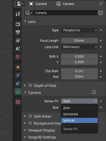

    Whenever I setup the camera constraints on a new project the min and max zoom constraint as set up in the verge3D camera settings in Blender work as expected on desktop, however on mobile it allows for a far bigger range of motion in relation to the size of the object – meaning I start with a small zoomed out object, and I can zoom out further than on desktop.
    I need the object to fill the same portion of the screen on mobile as it does on desktop – any way to do this with the puzzles?

    This behavior is kinda expected as the aspect ration is very different on mobile.
    You can probably play with Horizontal or Vertical sensor fit for the camera and see if it helps.

    Setting it to Vertical FIT with Height set to 18 seems to have worked :) Works fine on mobile and desktop, thanks!
