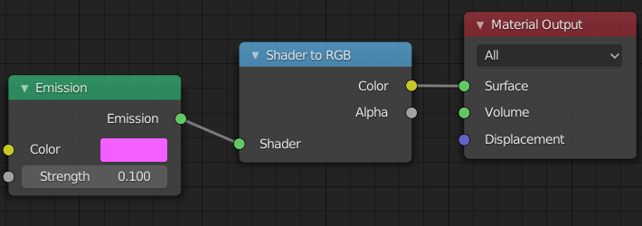

    Think I may have found another bug related to background transparency. This one is a little different than the last one I reported.
    When background transparency is enabled, emission materials with reduced strength appear transparent (or partially transparent). My example below is with the strength set to zero, but it happens with any value below 1.0.
    #24367
    Yes, that was a bug indeed. It will be fixed in the next verge3d update. Thanks for the report!
    By the way, I think you can apply a simple workaround to fix it for now: emission_shader.png
