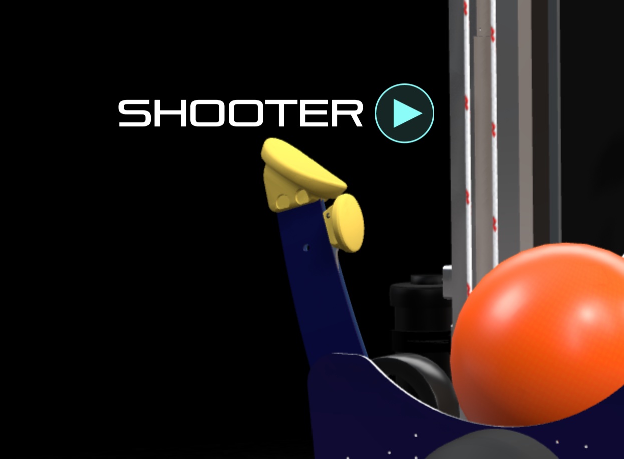

Question, have you done any demos on the sprites you use for the GUI? See the photo. I cant remember if this is something you covered yet, but I like how it always stays forward facing and stays the same size no matter where the camera is from perspective.

The way this was achieved in the Robot Explorer was HTML and CSS. However, the same effect can be achieved inside your 3D app. In Blender, you would create an image plane with text and button and then place a track to constraint on it to the camera to ensure it points in the right direction.
Given there are no SEO advantages for having HTML vs and image when using WebGL the image plane method works really well.

Thanks for the tip. I might have to try it out with my app. Right now I’m using the create a plane with texture, but I think using a div that can scale and always stays the same size makes more sense.

xeonCustomerIf you are using a plane object, consider parenting it to the camera, and then Clearing Parent Inverse. This will make the plane stay parented to the camera and allow you to use the Visibility Breakpoints in your V3D settings.
This will ensure the plane object is the same size and position to the camera no matter what and will act like 2D HTML overlay/annotation. I suggest making sure the object does not cast or receive shadows and you use an emmission shader so that it always evenly lit.

ParticipantXeon, that’s a good idea but the plane is a moving plane to show measurement. I had used the annotate function, but with that I cant style it at all. I think the first suggestion you had would be the best for me. I could parent the div to an empty that moves.

xeonCustomerah…. moving…. in that case….I would go with a div too.
