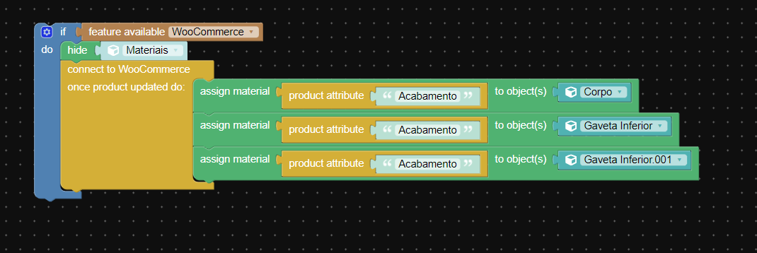

    I´ve been struggling with an issue integrating verge 3d and woo commerce and wordpress
    Can´t manage to change the product atributes like color and size through the woocommerce menu on my product page,
    I know the app is recognizing woocommerce since it hides the material blocks ive created, just like in the spinner tutorial, but the 3d model doesnt change according to the selections made on the dropdown lists made with woocommerce.

    Perhaps something with material/attribute naming. Use the print to console puzzle to output received product attributes, also check how materials are actually called in the modelling suite.

    I´ve managed to make the materials change, now comes the part wich I have no no idea how to progress..
    I´ve made the changes on size on the configurator by using morph factor on the object data, on a test it worked just fine, but i have no idea how to build the puzzles so it integrates with the woo commerce menu.
    Also, I cant manage to make some objects hide or show deppending on the selection. I dont really know how to link the object puzzles with the value chosen in atributes
