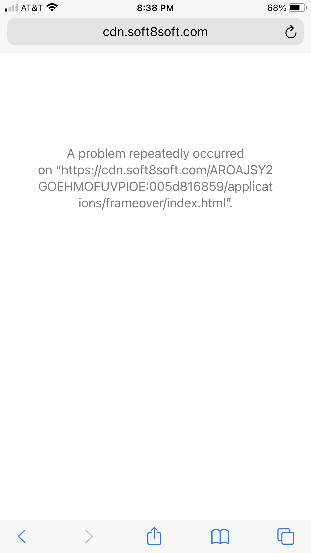

CustomerI tried to open this link in Safari on an iPhone and it loads the page three times and craps out. Same thing in XRViewer. It works fine on a desktop, and on my iPad (iOS14.7.1). Any idea what’s causing it? This could be a deal killer for this client.
Here is the link:
https://cdn.soft8soft.com/AROAJSY2GOEHMOFUVPIOE:005d816859/applications/frameover/index.htmlI’m attaching the screenshot from my phone.

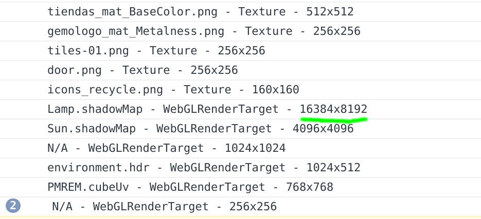

Yuri KovelenovStaffHi John,

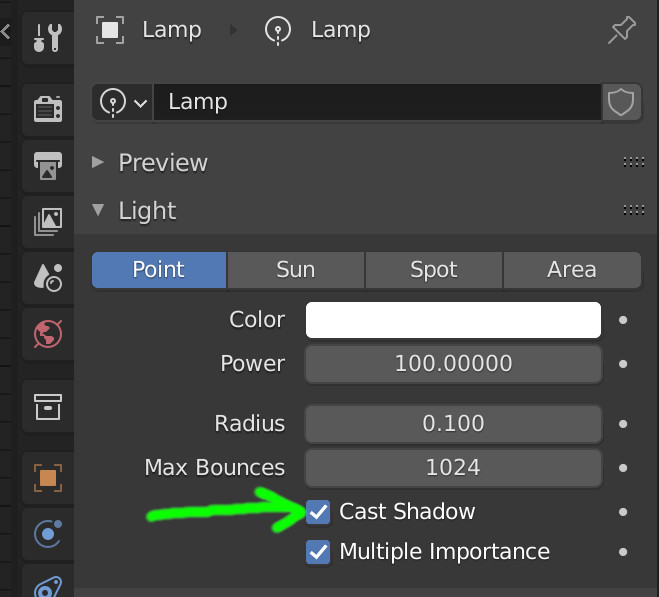

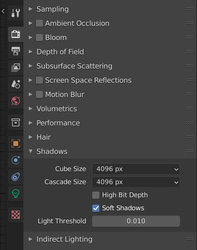

I invoked performance profile on your Verge3D scene (hot keys P-P-P , works without iframe) and it shows that it uses a very big shadow map (16k x 8k). Such a map alone occupies ~0.5 Gb of memory.
The reason for that is that Point lamps use cube maps for rendering shadow (6 maps atlas), and in your shadow settings you set their size to 4k.
This is really slow and takes a lot of memory so I’d recommend disabling shadows for your Point light (or make shadow map size 256 px).
