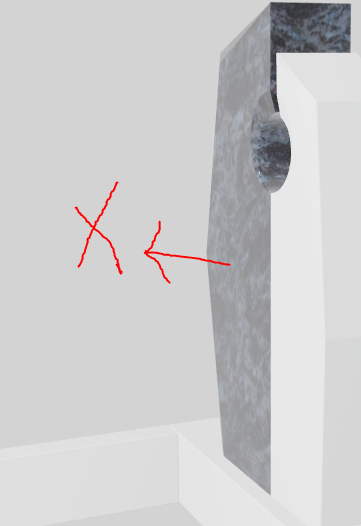

    hey,
    I know my lighting isn’t up to the point but I just want to know if this is just a verge3D thing. At very oblique or slant angles there is a white screen that appears on my model (x). I have enabled screen space reflections. I want to know if this is just a verge3D(unavoidable) thing or can i fix it with better lighting techniques or tricks.

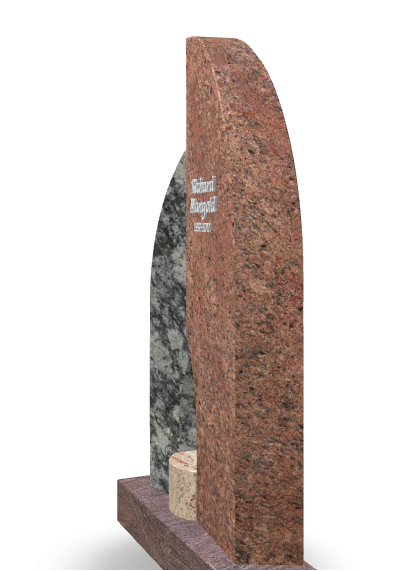

    I want the result like in the example.png, which doesn’t form the white screen.
    #45134
    Well…without seeing the project and blend file I can state for sure.
    However, since the white is cast over the entire face I am pretty sure this is a material setting. I would dial down the specular and any reflectivity you have and bump up the roughness.
