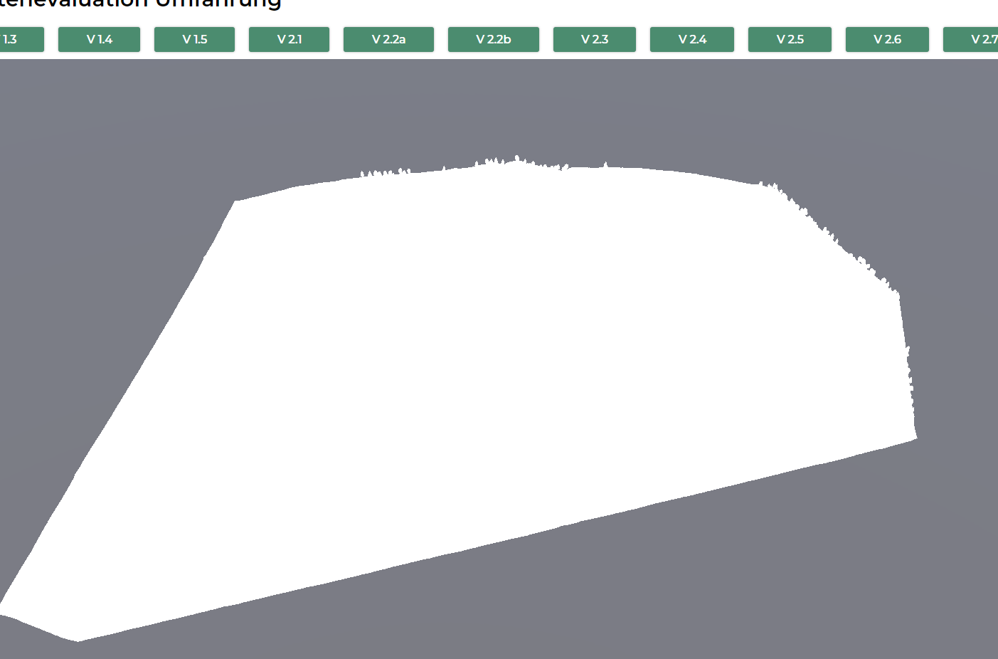

    Hello,

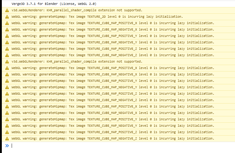

    The model is loaded correctly but rendered all white (check the screenshoot) only on certain devices. I am using an athmosphere plugin in Blender and the sky isn’t blue as it should be. It seems to not render the illumination properly. I checked all the settings & documentation but no solution. How can I fix that?
    I have tested it with multiple browsers and devices.
    They all run on Windows 1909 and with different AMD GPUs.

    Swap that out and lets see what you get. If you could also post an image of the Blender Render view it would be helpful.
    I clicked on the link provided and do not get the scene you show in the image you provided. You might be doing your own testing. Let me know if there is another link.
