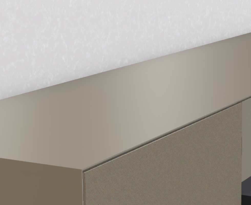

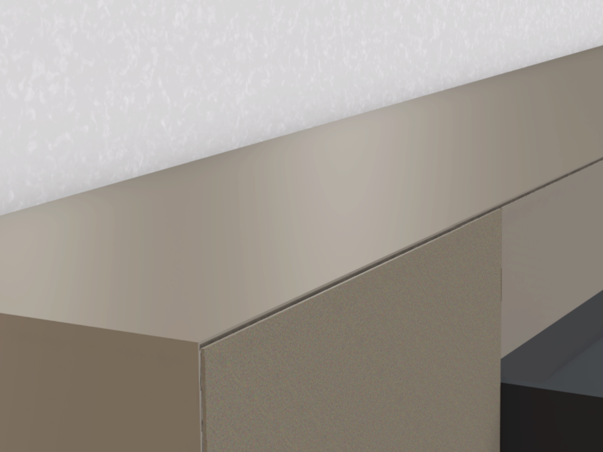

    I noticed that when I disable rendering, there is no more dithering and I get banding especially around highlights on a material.
    See attached. 01 is when rendering stopped, 02 is while rendering is active. Is there a way to avoid this?
    I tried the dithering settings in the material but that had no effect.
    http://v3d.net/lk9

    Try to disable SSAA

    studiogijs
    thanks that works! :good:
    So AA causes this bug of banding, or is that the inevitable price to pay for AA? In other words there is no way to get best of both worlds?
    #66534
    Not AA in general but an additional SSAA pass. Do not use it. MSAA used by default is enough.
    #66542
    studiogijs
    okay, tbh I don’t see a difference in AA quality anyways, so I’ll take your advice!
    Thanks again!
