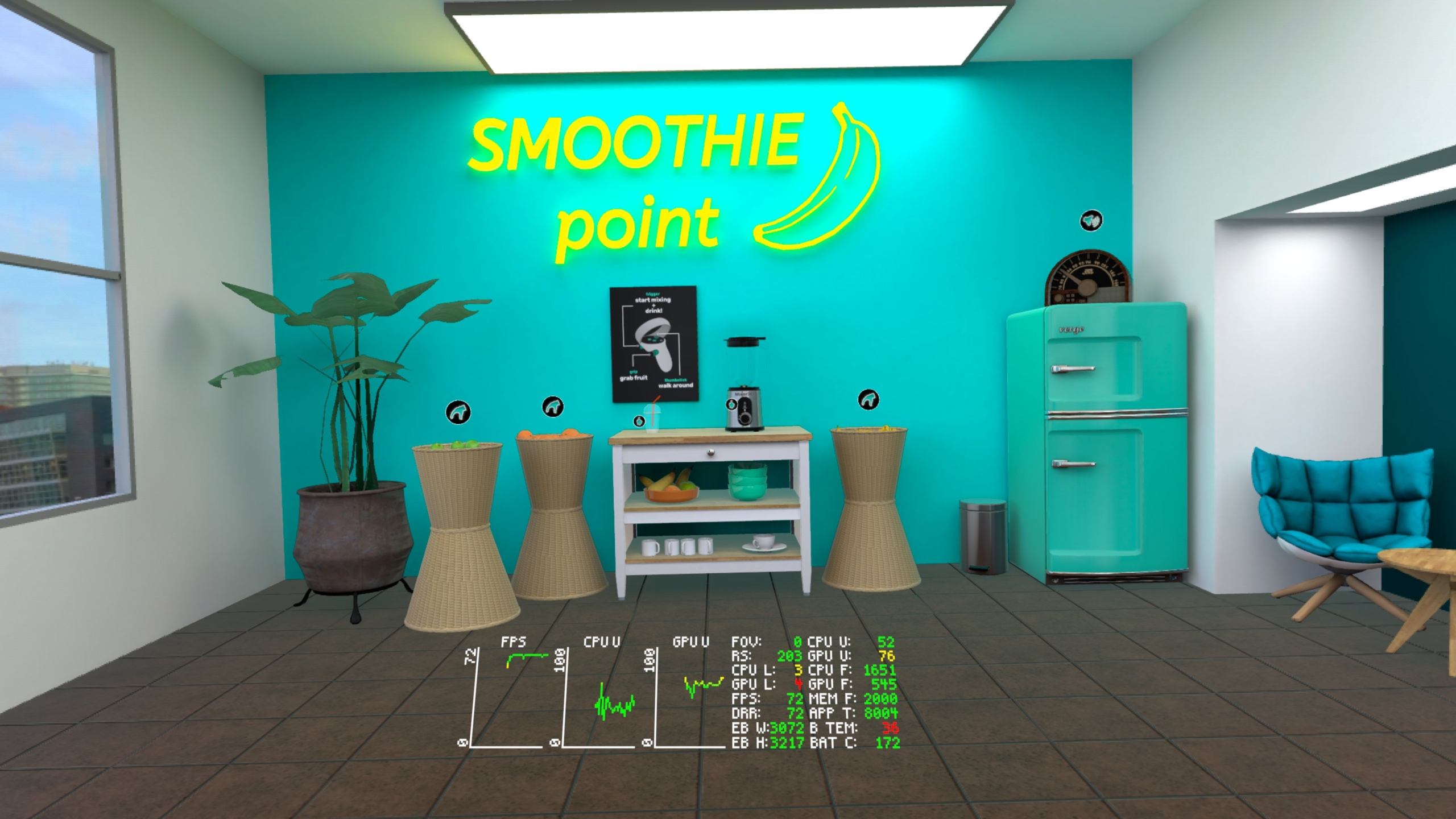

    my scenes with higher polycounts would completly collaps.
    not a fact. can you share your app for testing? kdv (at) izh (dot) com
    in my Virtual Reality Demo it runs smoothly at 3072 per eye with 72 fps
