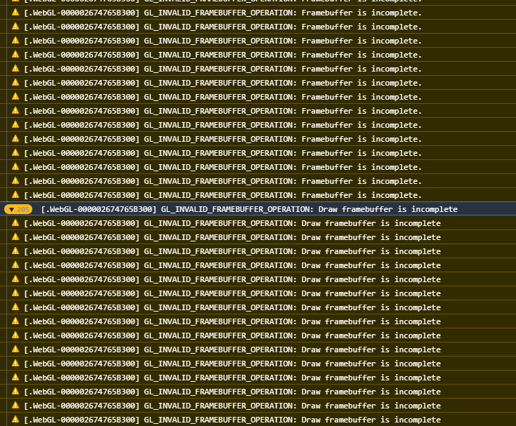

I’m having console warning and 3D won’t load anymore
[.WebGL-000002B7C560B0A0] GL_INVALID_FRAMEBUFFER_OPERATION: Framebuffer is incomplete.
[.WebGL-00000230C002D480] GL_INVALID_FRAMEBUFFER_OPERATION: Framebuffer is incomplete.
[.WebGL-000002B7C560B0A0] GL_INVALID_FRAMEBUFFER_OPERATION: Draw framebuffer is incomplete
[.WebGL-00000230C002D480] GL_INVALID_FRAMEBUFFER_OPERATION: Draw framebuffer is incompleteChrome version: Version 87.0.4280.66 (Official Build) (64-bit)

CustomerStill
But now it’s a different code
[.WebGL-000001C88DD1CB50] GL_INVALID_FRAMEBUFFER_OPERATION: Framebuffer is incomplete.
[.WebGL-000001C88DD1CB50] GL_INVALID_FRAMEBUFFER_OPERATION: Draw framebuffer is incomplete2020-11-27 at 8:14 am #36006

CustomerIn Mozilla too. Please see attached files

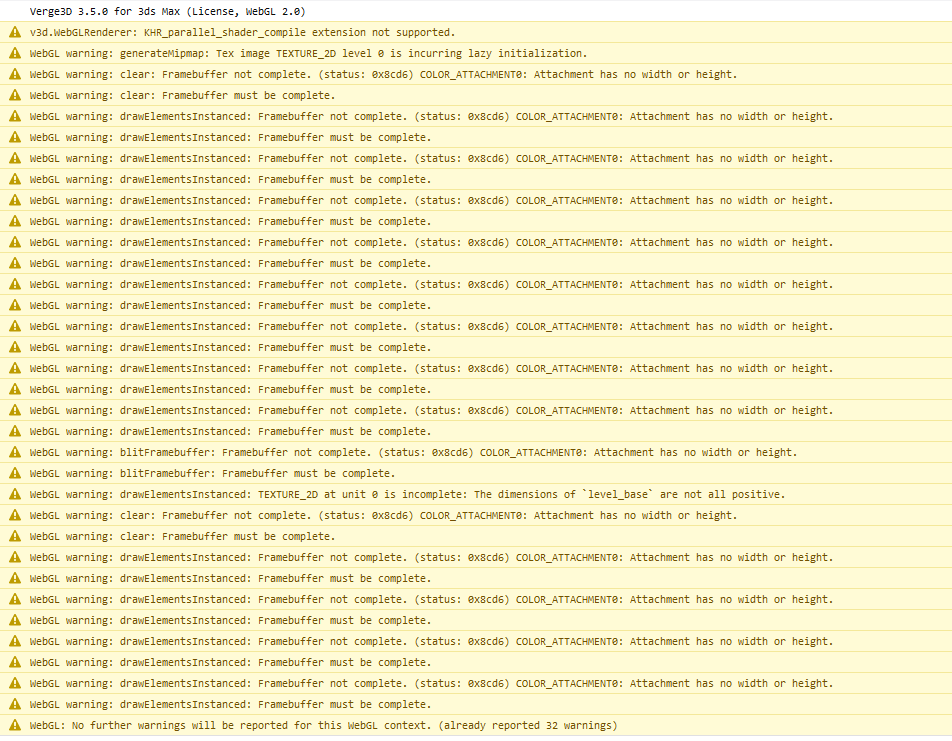

Yuri KovelenovStaffmay be the Angular app sets it somehow to zero? May be this solution can help
https://github.com/jtblin/angular-chart.js/issues/1692020-12-02 at 8:07 am #36162ninojoevelz(old)
CustomerHi, still no luck
I’ve run through different versions of Angular and Verge3D. I keep wondering what causes the issue. And I think also there is something in the Angular app that conflicts with the rendering of the 3D something but this was really working before with Angular
2020-12-02 at 10:02 am #36166ninojoevelz(old)
CustomerHi, I found the issue now. It turns out I missed these styles
#v3d-container { position: absolute; top: 0px; left: 0px; width: 100%; height: 100%; }
