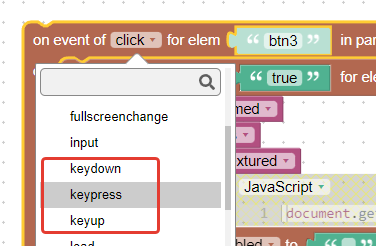

    but not for keyboard Events.
    See the magic
