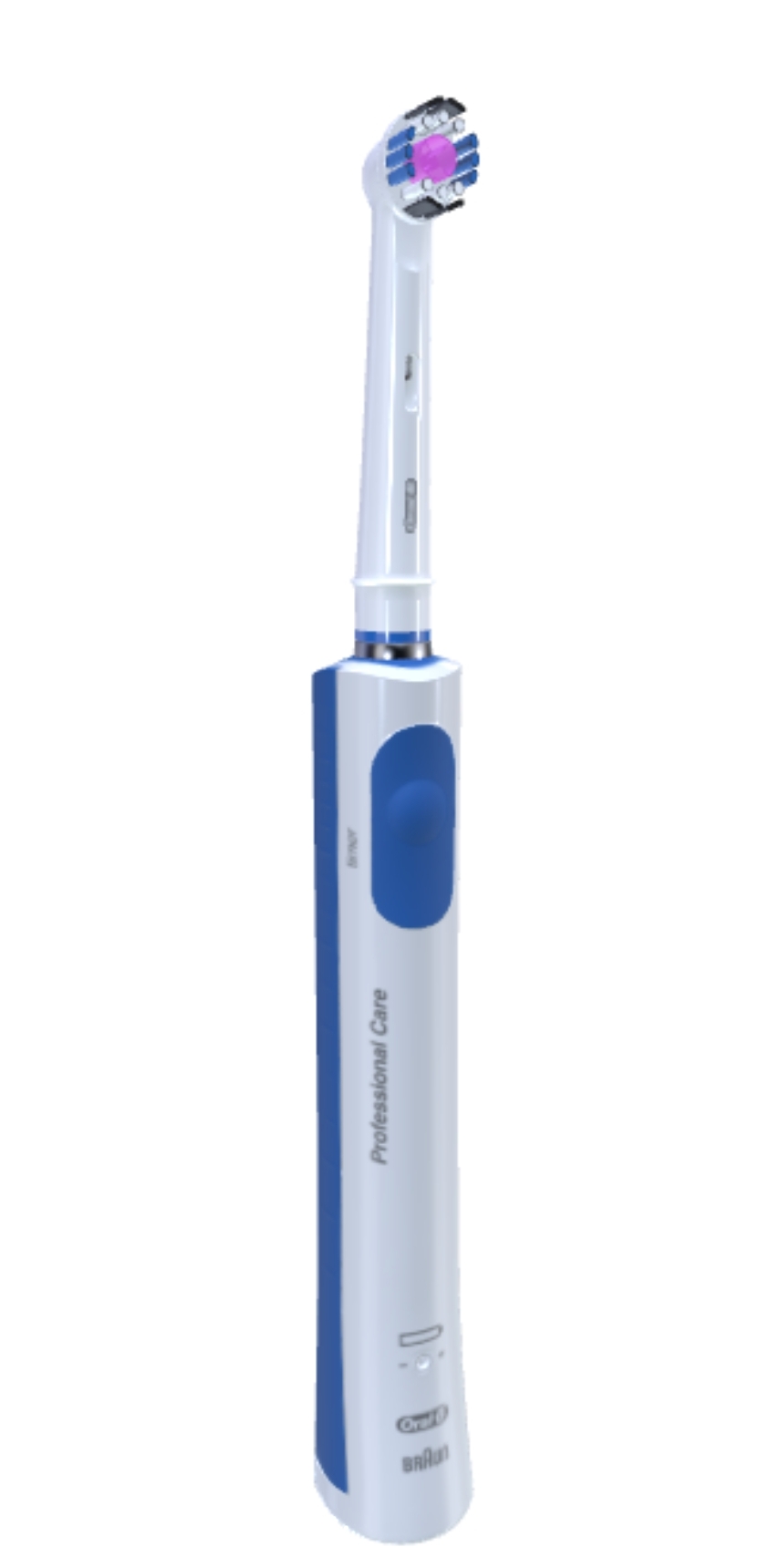

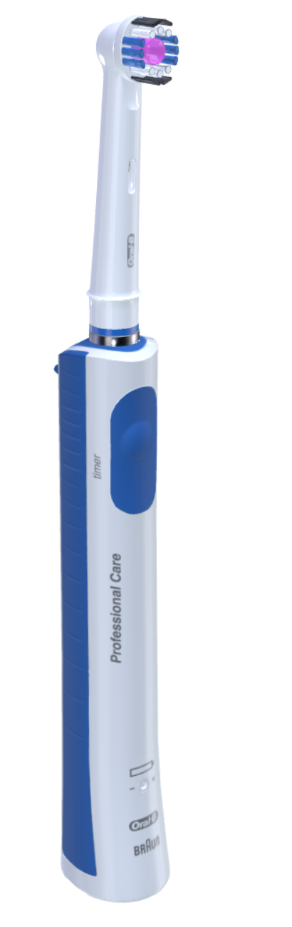

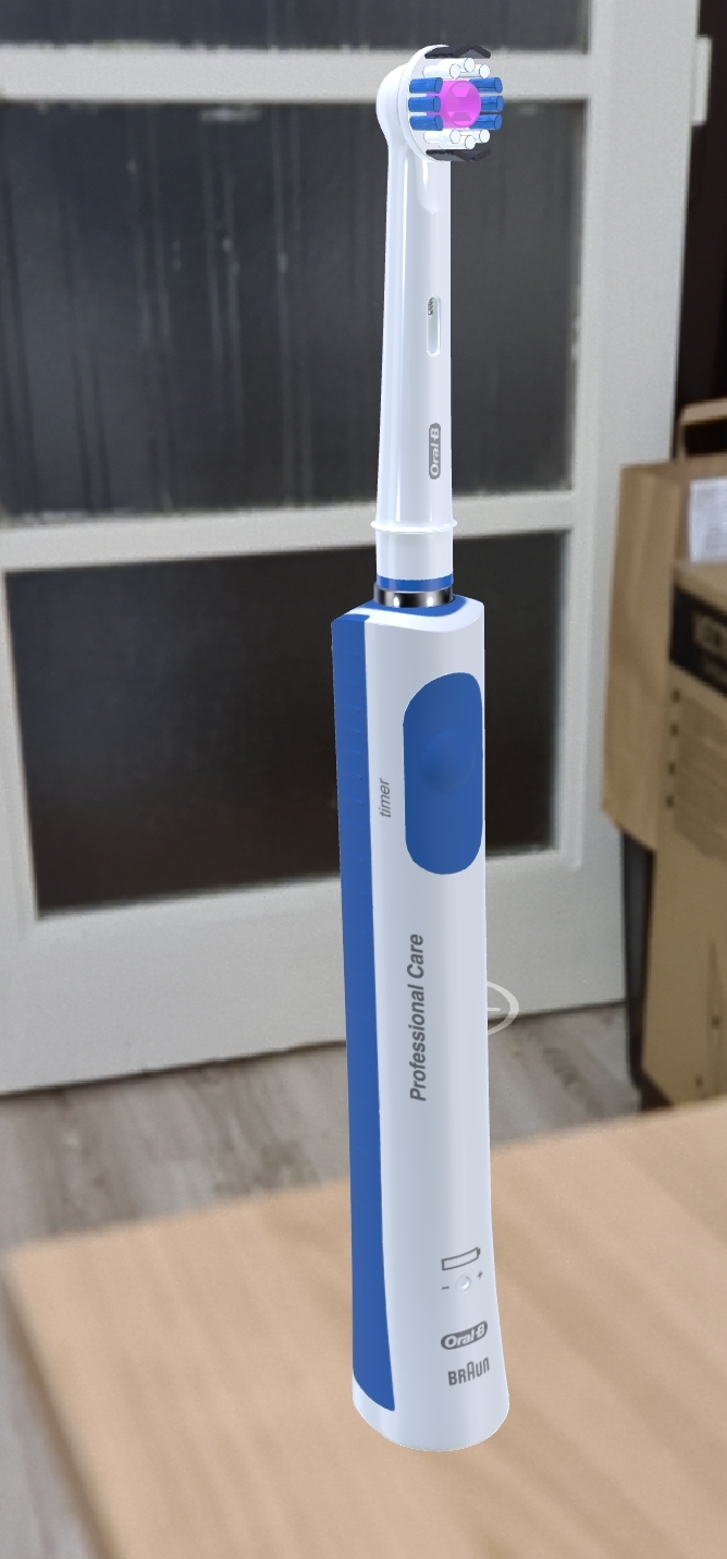

    While displaying our products on mobile devices, both Android and Iphone, we are sometimes experiencing noticeably lower quality rendering.
    I am attaching screenshots to demonstrate:
    – example 1 one is from desktop usage in Chrome browser
    – example 2 is from AR display on Samsung Galaxy S20 ultra
    – example 3 is from Chrome browser in mentioned cell phone
    It is obvious that both AR version and desktop version are sharper and/or has higher resolution than cell phone browser display (we see similar worsen looks on iphone).
    I am familiar with underlying Three.js library.
    Question: Are we doing some render scaling on mobile devices in web browsers*? And if so, how can we control it? The point is, we would like to control this quality setting ourselves (ideally display highres on higend devices etc).
    *From what i remember, Three.js has renderer.setPixelRatio(aspectratio) which looks very similiar. Is it the case?
    thank you very much in advance,
    Petr Sehnal, Precismo
    #34298
    matthijsbinmat
    You can set screen scale with the the screen scale puzzle. (in puzzle editor go to system tab)
    https://www.soft8soft.com/docs/manual/en/puzzles/System.html#set_screen_scale
    #34299
    precismo
    Thank you, this is exactly what i needed!
