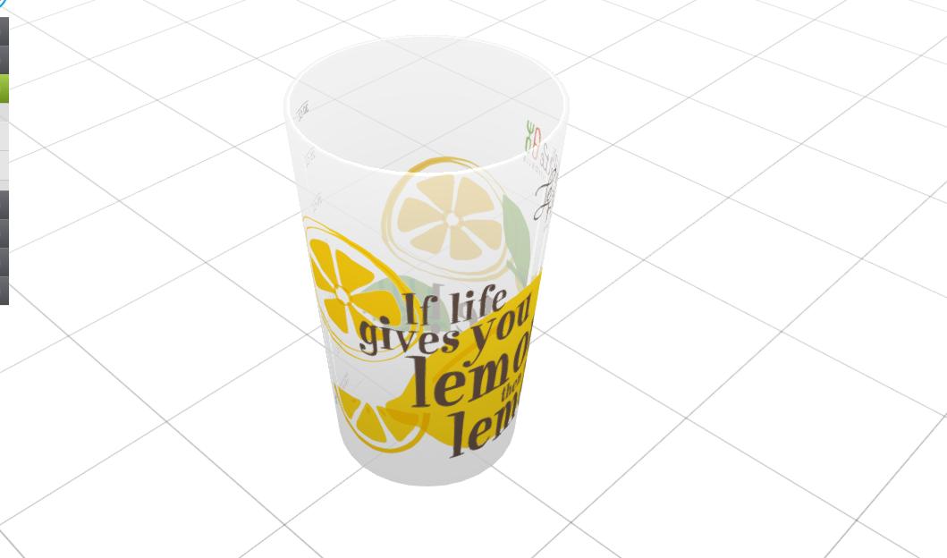

    Screenshot of b4w result i need in blend 4web, with opacity adjustable

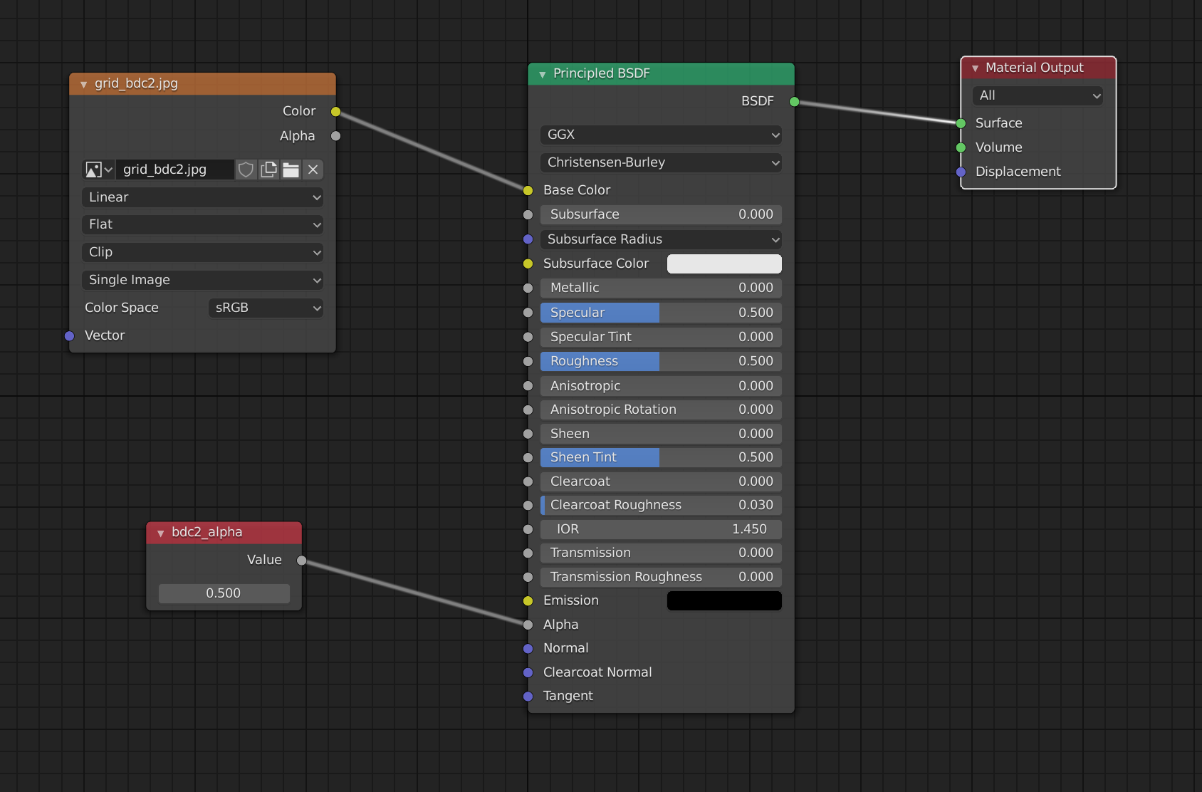

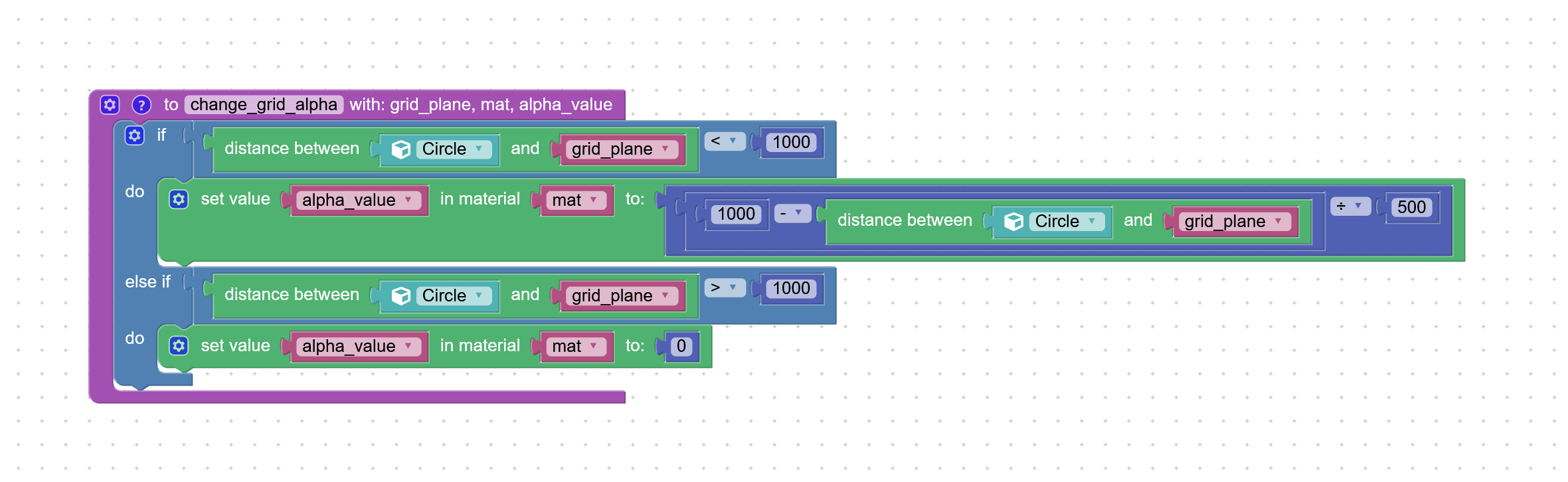

    Here is a simple setup I made for one of my Projects. The material alpha changes depending on the distance between the camera and the object (far = alpha0; close = alpha1).

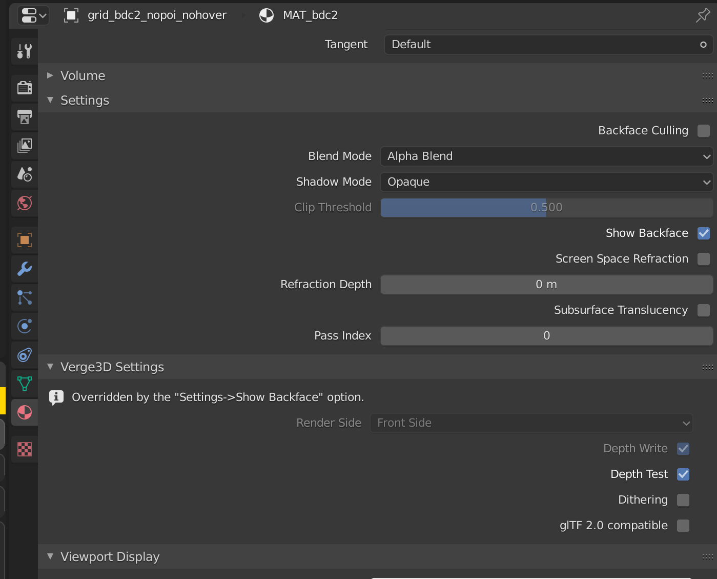

    You have to plug a value node to the alpha channel of your material, that you can then control in the Verge3D puzzles. I also put a screenshot of the material settings (alpha blend).
