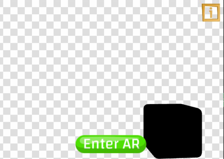

    I am just playing with the farmer kid AR scene and found that placing a metal cube with the reflections assigned ( environment map ) appears dead black in AR mode.
    how do I enable the reflection of world environment texture in the cube or any object.
    do I have to do some settings in puzzle editor ?
    #82034
    For optimization purposes we disabled IBL environment in this demo, please switch it back to PMREM:
    #82048
    visualizer
    Yes. Got it working perfectly. :good:
