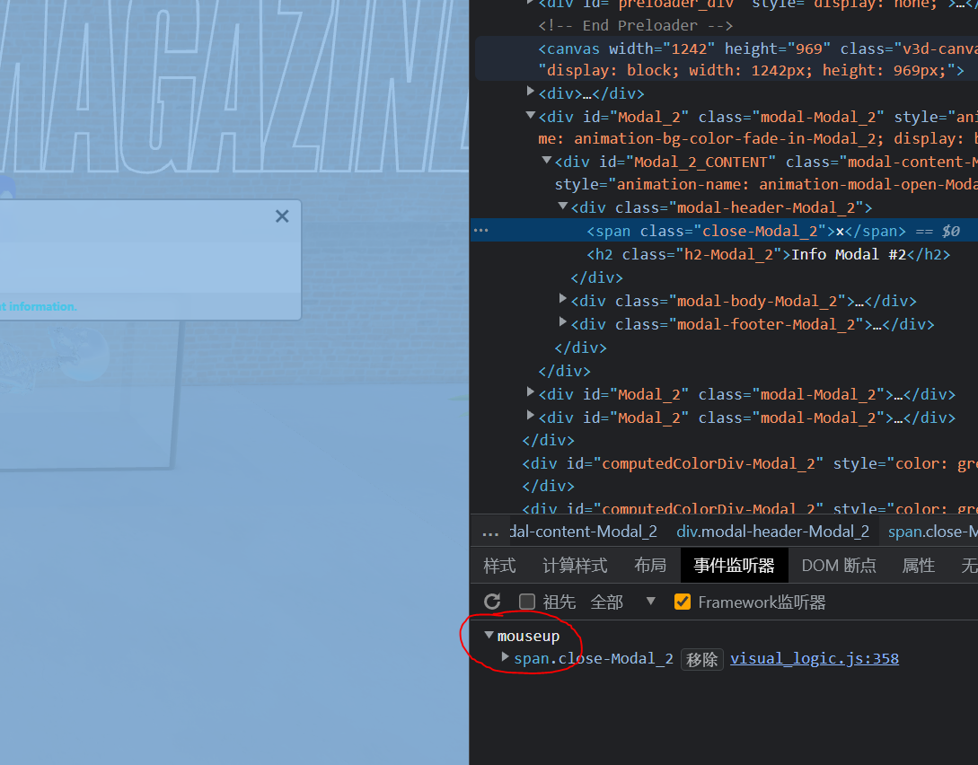

zjbcoolCustomerSorry, I can’t do that(beautify the code) without the agreement of the another plugin’s author. It seems you only choose one of them. Also it’s a problem for plugin develpers when users use different plugins from different authors. I have no idea how to handle the problem.
I can finger out the issue for you, But I can’t fix it. see the screenshot.

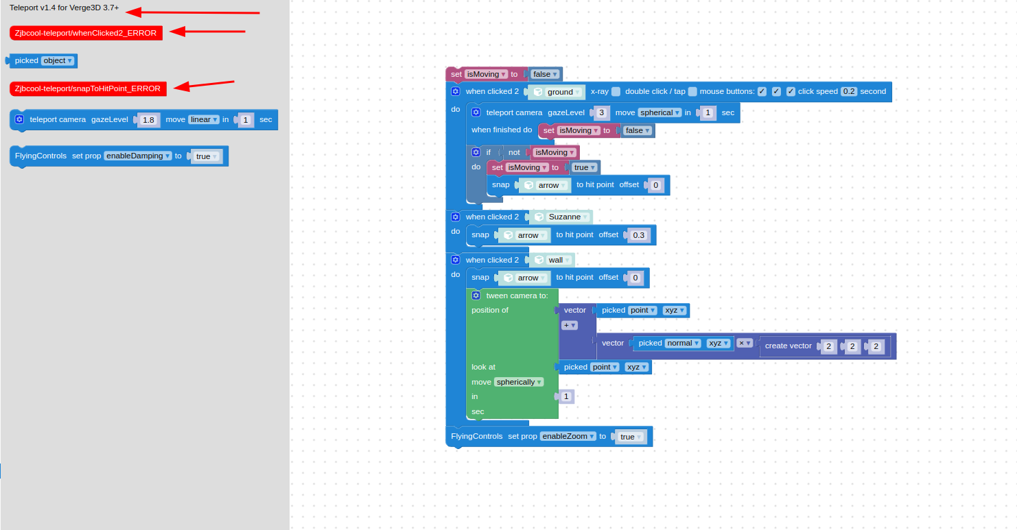

ParticipantRunning teleport plugin 1.4 on Verge 4.4. Could not seem to operate inside the puzzles editor.
The example works in the browser, but my project does not.https://snipboard.io/tZw9ng.jpg
https://snipboard.io/bTLs6C.jpg2023-11-28 at 5:47 am #68828
Yuri KovelenovStaff2023-11-28 at 7:52 am #68832kdv
ParticipantSend me this plugin (and your example). I’ll fix it.
