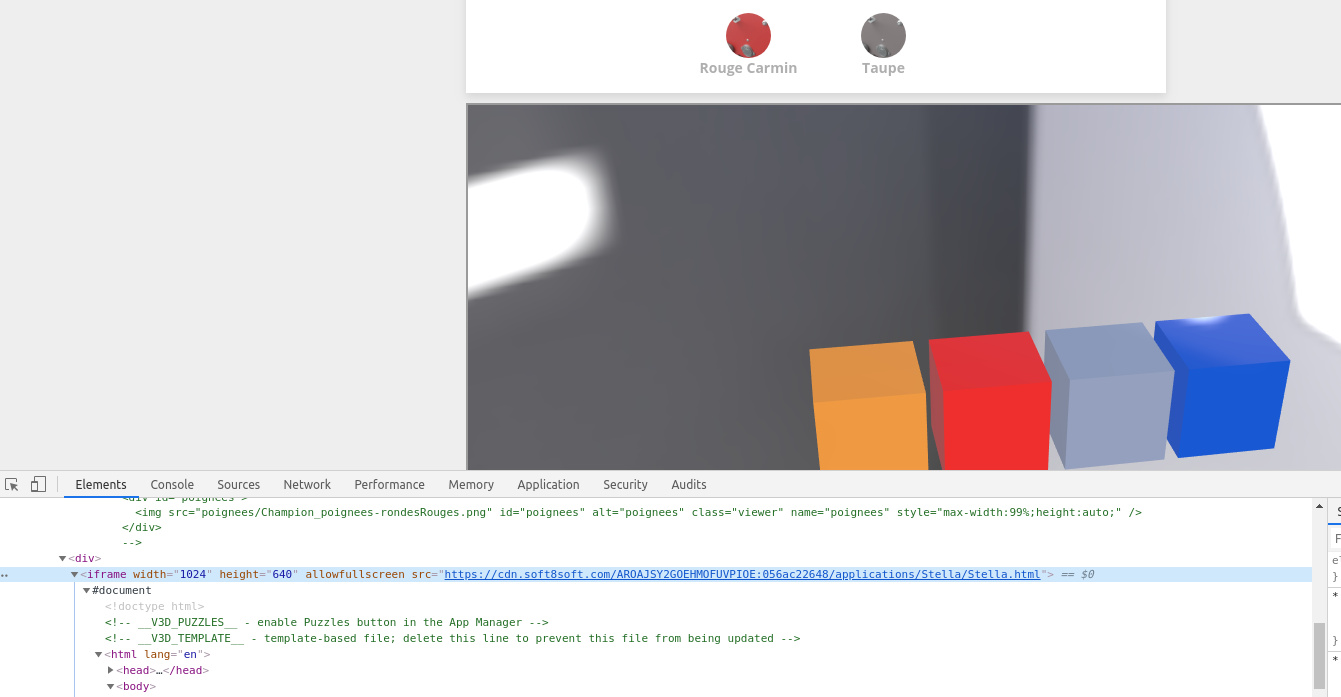

NaxosCGCustomerVerge3D in iframe can’t get html ids triggered.
Instead of creating a html website like in the tutorial, i’m trying to put a Verge3D iframe scene in an existing html website, as a test.
I could get the button’s IDs, so i’ve used the typical “on event of click…”
see joined puzzle picture.I’ve then saved, published and put the iframe code inside the existing website : i can see the scene, i can click on inside objects to change color of another, but all the clicks on html buttons (see other pictures) does not trigger anything.
Any idea ?
[Edit] : of course i’ve tried both “in parent doc” on & off.

Yuri KovelenovStaffHi,
The verge3d stuff is published on soft8soft network (i guess).
I think this is a security issue – JavaScript (on which the Puzzles are based on) is not allowed to access a web page which is hosted on a different domain. Try to host both html documents on the same server.

Yuri KovelenovStaffBut when i copy all files on a friend’s server for test, buttons are not working :
you also need to change the path in the src attribute of your iframe (make it relative, not absolute). It still points to Verge3D Network.
