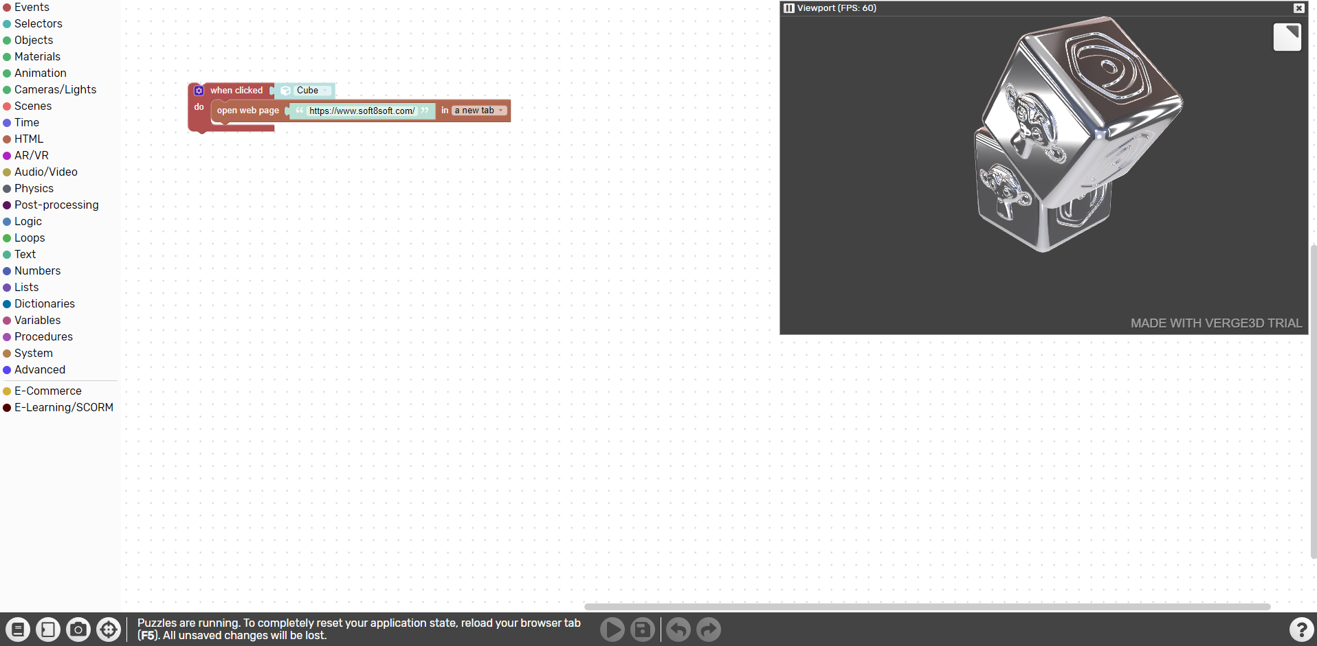

    Im new at this technology and Im stuck in this problem
    I created a new app in Verge3d app manager
    added a click event on a cube in puzzle
    then i click save button
    and when i open the app in blender and go to sneak peek that click event doesnt work
    AND
    when i open the app in blender and get a gltf export from it and use it in threejs ( using gltf loader ) that event click still doesnt work
    totally I mean it only effect on html file . what should be my puzzle that this click effect on gltf file too?
    please give a solution to me thanks :-( :-(

    Sneak Peek only previews the gltf file – it does not apply puzzles. More on that here https://www.soft8soft.com/docs/manual/en/blender/Beginners-Guide.html#Running_Your_App
    Three.js may not accept Soft8Soft extensions to gltf. You can switch on the ‘gltf 2.0 compatible’ checkbox for your materials which will export ‘standard gltf’.

    so is there a way I can make each object in blender clickable?
    I want to design a group of logos beside each other that when user click on every one it goes to there website
    thank you so much
    #51165
    check out this tutorial https://www.soft8soft.com/docs/manual/en/blender/Beginners-Guide.html#Puzzles
