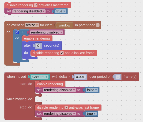

Yuri KovelenovStaff2019-05-14 at 10:46 pm #14763jem
CustomerHey Elk,
Were you able to implement your re-render upon going full screen function? I am experiencing the same behavior. If you have solution, would you mind sharing? Many thanks, Jem.Jeremy Wernick
2019-05-15 at 9:48 am #14785
Yuri KovelenovStaffHi Jem,
you can use the resize event listener to handle entering the full screen mode:

2019-05-15 at 8:34 pm #14821jem
CustomerElk and Yuri,
Those are great explanations. Those techniques fixed my issue. Although my ultimate solution was closer to Yuri’s suggestion, Elk’s “every frame” loop solution has me thinking about other possibilities… Thank you both for sharing!Jeremy Wernick
