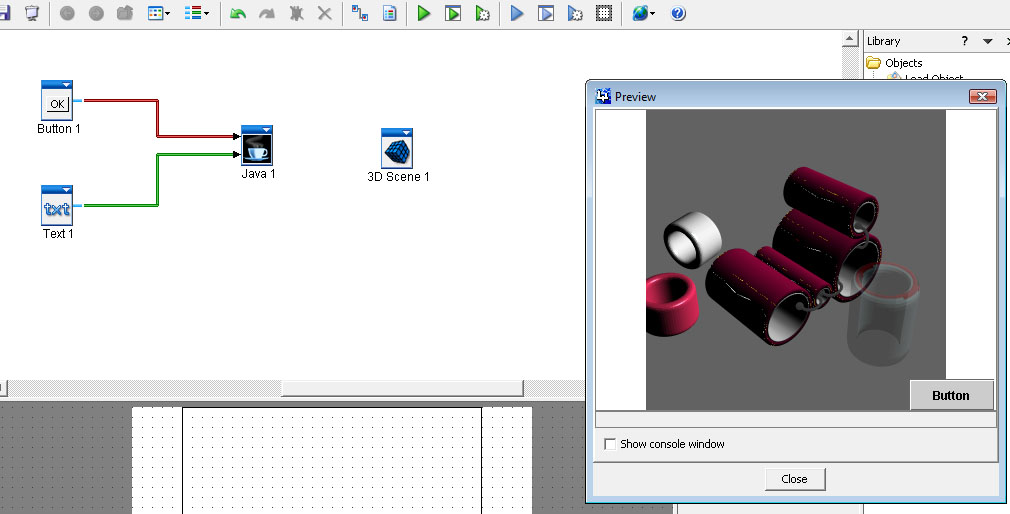

NaxosCGCustomerJust to tell, if you guys need an open-source java-coded GI renderer, SunFlow may still be available
I dream about a nice, simple-to-code, no plugin required 3D tool (like Verge3D) that would let the final user to click on abutton to start a nice render (like Keyshot / VrayRT / Corona IR), or when the user stop moving the mouse (like for the AA).
That would be so great !
2019-04-15 at 10:22 am #13900
Yuri KovelenovStaffthat would let the final user to click on abutton to start a nice render (like Keyshot / VrayRT / Corona IR), or when the user stop moving the mouse (like for the AA).
That is a great idea! This can include GI, quality SSAO, reflections etc. We should definitely think about this.
2019-04-15 at 10:37 am #13901
NaxosCGCustomerMaybe not the full package as Vray / Corona renderes, as we more often use Verge3D for packshots / configurators of objects, not interior archviz scenes…
But please have a look at Keyshot : it is a packshot renderer (they also put some heavy Gi for interiors too, but not really usable)…
There was a time i’ve managed a project like this one : my coding guys have put SunFlow into Wirefusion… And it worked good : change colors / materials, turn around, then clik a button to get a nicely rendered picture.
Unfortunatelly, Wirefusion is no more (good for you guys), and the project is left behind some 10 years ago.Attachments:
2019-04-15 at 10:39 am #13904
NaxosCGCustomerhttp://sunflow.sourceforge.net/
Sunflow is a bit old, but could do the trick for packshots.Of course, the best would be to get some connexion / partnership with Corona Render
2019-04-15 at 11:06 am #13905
NaxosCGCustomerI would have made an animated gif to show the stuff working, but Java applets are no more allowed on windows10 web browsers…
