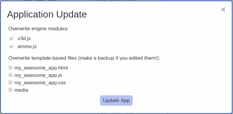

    Just a quick thing i noticed. There is no option to include physics if you update an app from within the app manager.

    Sorry for the late response. We fixed that in pre2. The option is called ammo.js.

    elk
    No worries Yuri.
    Hmm, strange. It does not show in my App Manager(see image), or has there been a change to the pre2 so I need to download a new one ?
    Had a quick look for the custome reticule also in pre2, I guess i must be looking in the wrong place …
    #11942
    This dialog only lists modules that are used in the app. If an app was initially created without physics, the physics module wouldn’t be listed.
    I’ll answer about customizing the reticle a bit later.
    #11943
    elk
    I see. I thought it should be possible to add it while upgrading, not a big deal tho as a could always update it the old way. Thanks for quick reply.
    #11944
    Yep, it should work this way too. The ammo.js module can be copied from the verge3d/build folder.

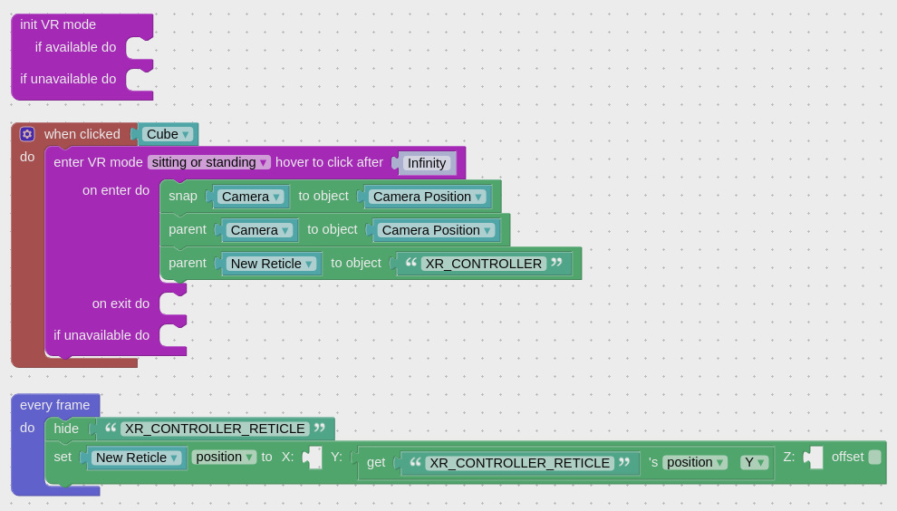

    Check out this minimalist demo on replacing the default VR reticle.
    There are special objects XR_CONTROLLER and XR_CONTROLLER_RETICLE that are accessible through Puzzles. Any object modeled/textured in Blender (or Max) can be used as a reticle.
