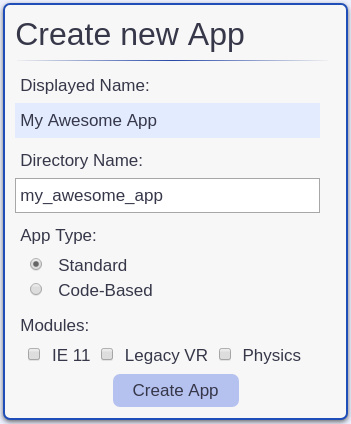

The Physics module can be added upon app creation using the corresponding option in the App Manager.

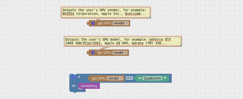

New puzzle get GPU vendor/model allows for detecting the user’s graphics hardware.

elkCustomerJust a quick thing i noticed. There is no option to include physics if you update an app from within the app manager.
