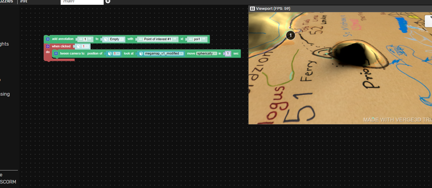

    However, I have been trying to make annotations a navigation object, so that when clicked, the camera will fly to that spot. I can do this with another object with no issue, but when I select the annotation (which is listed in the set of clickable objects) it does not work.
    Am I doing something wrong, or is this a bug?
    Thanks, Andrew

    Please show screenshots of the puzzle When Clicked.

    Attached screen shot.
    the annotation number goes red in the puzzle – yet it is listed as a useable object.
    #49747
    Because Annotatiion it’s and html objects you need to use HTML puzzle On Event of Click instead.
    #49799
    PLAN8
    Ahh, yes, that works – thanks.
