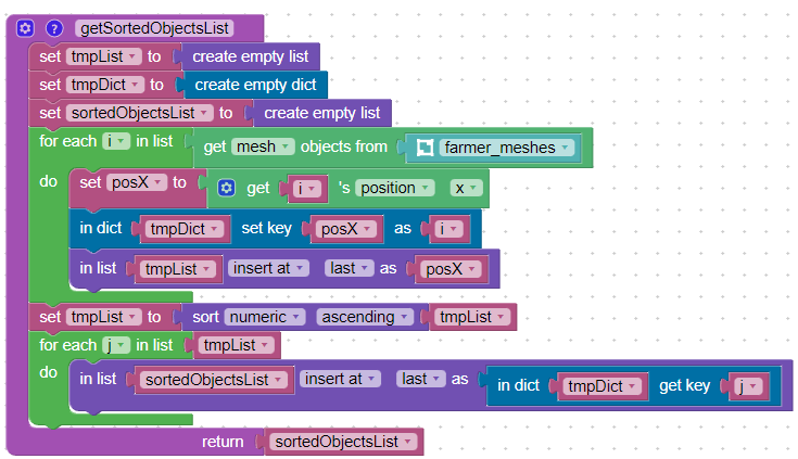

My project has an option to load multiple objects onto the scene (could vary based on request) and I need to keep a list of the objects on scene and adjust the order based on location of let’s say the y-axis (horizontal). Let’s say we have object A B and C loaded. I want to show the distance from A to B, and B to C which isn’t a problem if I keep in that order. But if I move an object so now the order is C A B, I get into trouble because the order of my list wants to measure based on the original layout. I can use the sort numeric puzzle to sort location, but then I don’t have the object name that I’d need to adjust the order of the objects by name.
Does anyone have a solution or any ideas on how to approach this issue?

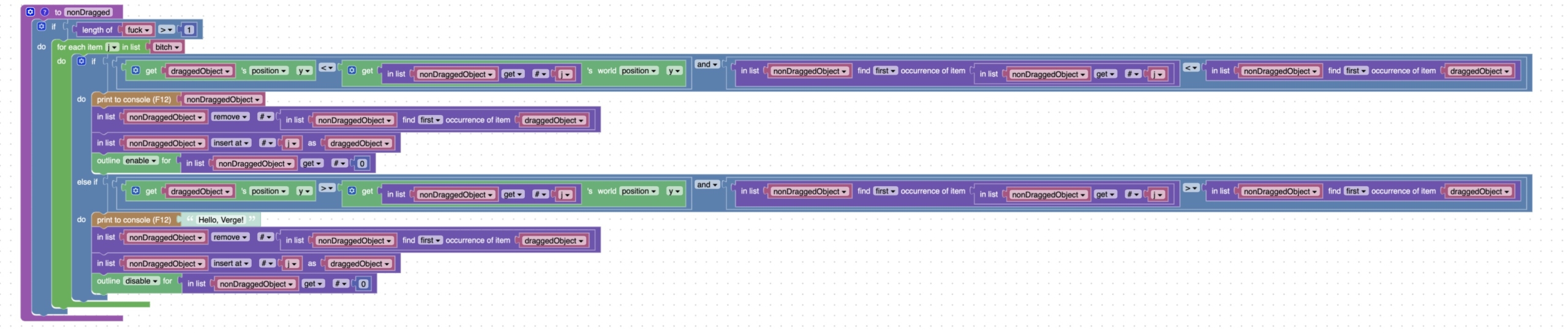

ParticipantI have a draggedObject variable assigned that tells me what is moving/last item moved. I also have a list of nonDragged items and a list that adds a counter when items are added so I can loop through the list.
I’m stuck on the logic needed to organize and update the list based on location.

2023-10-30 at 4:29 am #68061bigmike814
ParticipantWanted to update that I figured it out. I’ve included my solution if anyone is ever researching a similar issue in the future.

2023-10-30 at 10:04 am #68067kdv
ParticipantIf you save positions and names to a dictionary you can easily restore the names after sorting.
2023-10-30 at 12:37 pm #68072bigmike814
ParticipantNice solution. I ended up coming up with a different solution that seems to work, but I’ll try yours out.
Here’s what I came up with. I tried to post the code, but it was rejected. We’ll see if this works.
