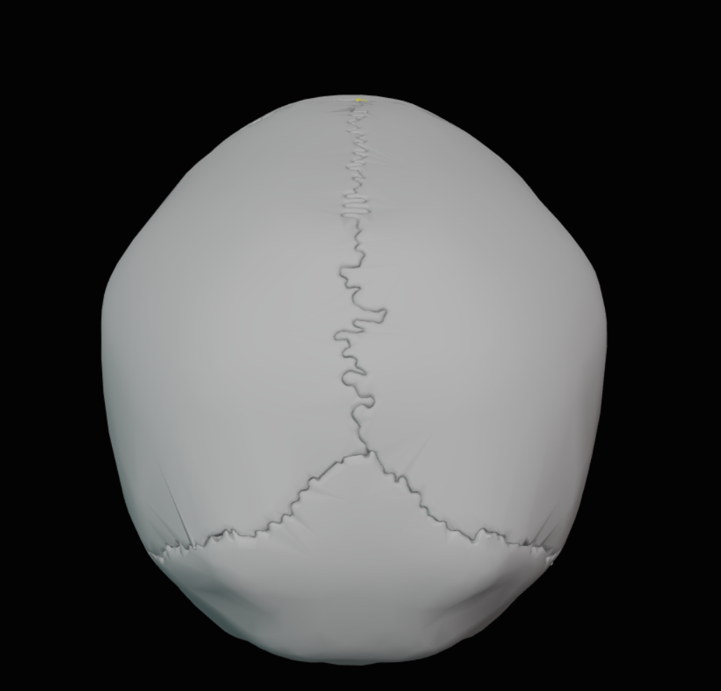

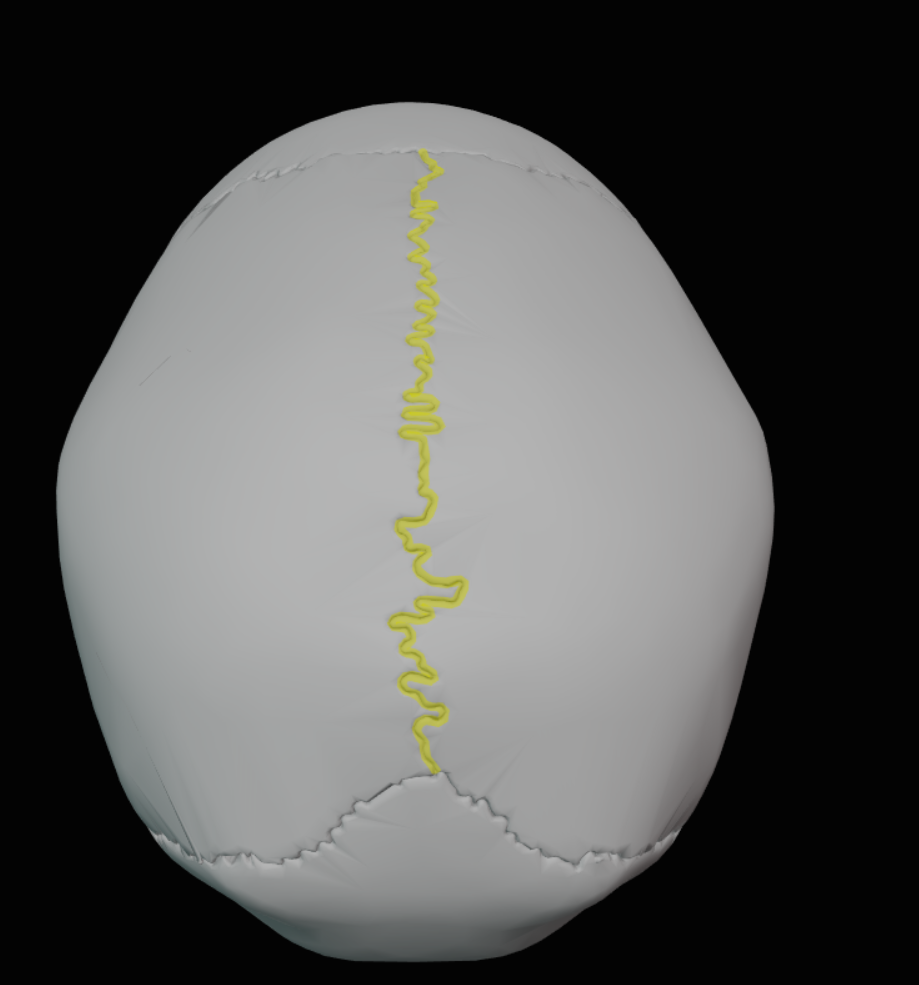

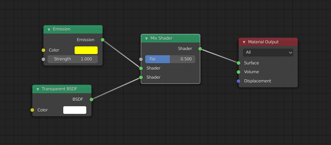

    So I have a small problem that my transparent shaders disappear when looked at in certain angles. I attached 2 photos of when you can see the material and when you can’t at just a very slight angle difference. I also attached a picture of the material I am using.
    Any help on how to fix this would be great.
    Thanks

    this may happen if the materials for both objects are transparent. If this is the case, you can try to tweak the rendering order
    https://www.soft8soft.com/docs/manual/en/blender/Transparency.html

    The material I have underneath has no transparency, it is just an emission, however changing the render order of the transparent object seemed to work.
    Thanks
